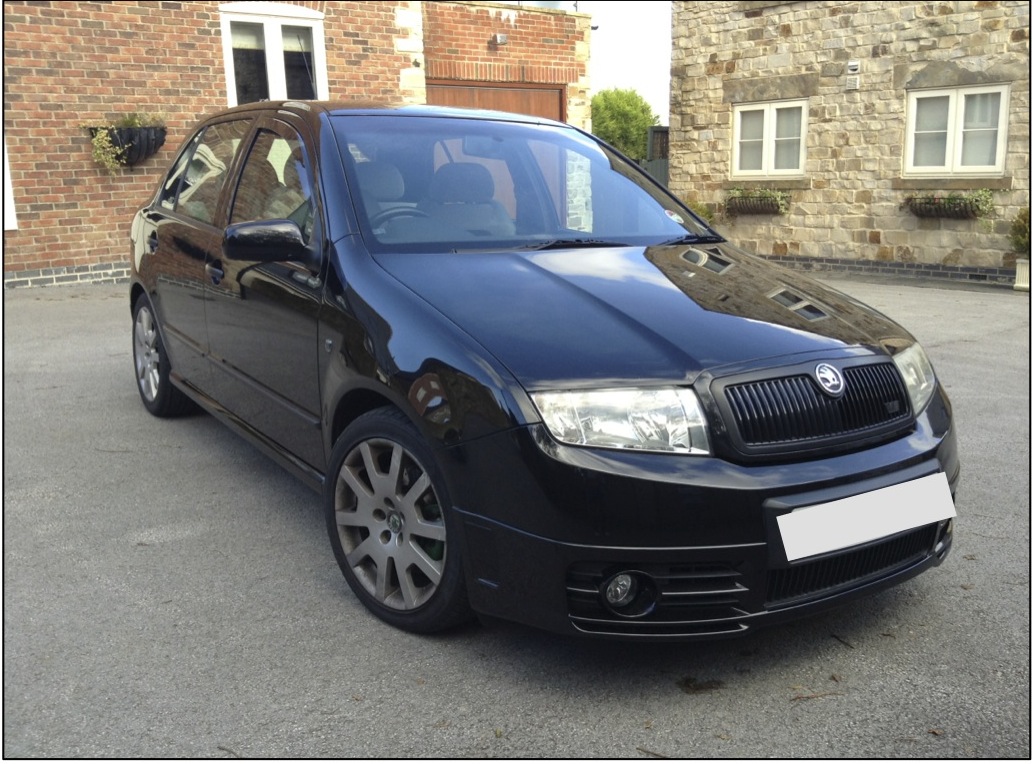

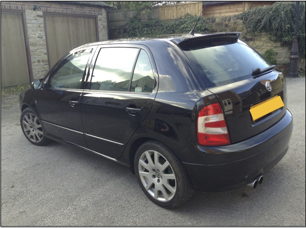

Here's SWMBO's latest Fabia vRS;
It's a 2005 '05' model, and it's had 2 owners before her, a pair of mature brothers (not boy-racers!) and has only done 40,000 miles with full history.
The Black Magic paint is virtually unmarked, as are the alloys, which is a bonus, although at some point I think they'll be refinished in a shadow chrome finish.
The first owner had heated front seats fitted as a factory option which is nice for the winter, especially as I've got a degenerative back condition....

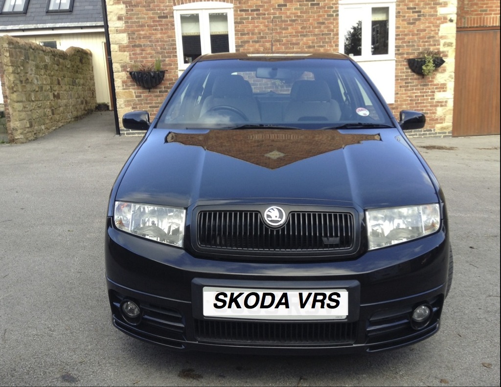

when the car was bought, it had some of PastyBoys badging, namely on the bonnet, boot and wheel centre caps in a carbon fibre finish.

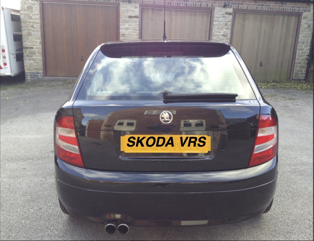

SWMBO decided to keep the centre caps, but bought the latest style Skoda badges (black and chrome - see the Images) for the bonnet and boot. However, she likes the look of the rear (i.e. not having the Fabia or vRS badging) so wants to keep it that way.
I did say 'the' rear, not 'her' rear, didn't I? Just checking.
Me? I'd go for a mk2 Fabia and vRS badge.
But she wears the trousers, cos she says so.....

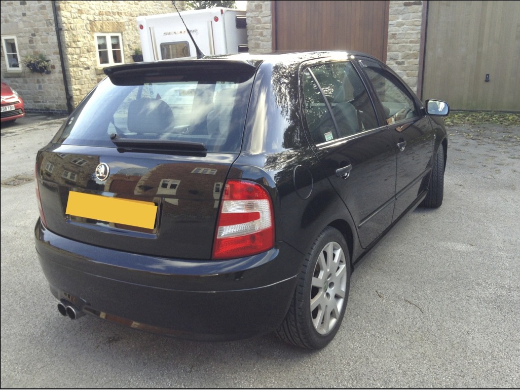

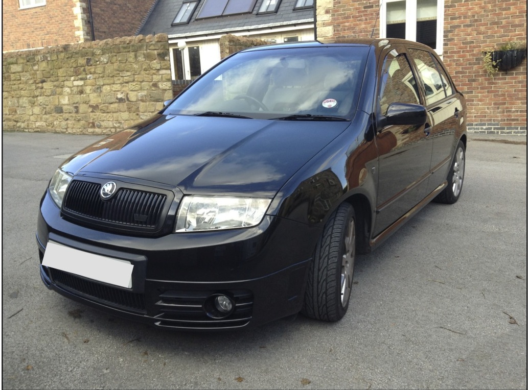

With regards to the paintwork, it wasn't bad to be fair, but me being me, I decided to give it a quick machine polish.
I say 'quick'.
I meant it took me 2 days (I AM disabled, things take me a while)
Of course this was after the usual wash, rinse, clay, wash, rinse, 2-stage polish, and before 2 layers of glaze, 2 layers of sealant and 2 layers of wax (all Chemical Guys products).
Not bad for an old cripple (yep, I can use that word, as a. I am one, and b. I'm talking about me!)
To be fair, the car really looks great, just got to get the seats cleaned (again, they're not too bad, but SWMBO really likes everything to be squeaky. Clean, that is....).
To clean the seats I'll be asking my dear brother-in-law to get them out for me (I can't manage them on my own due to my useless back...) prior to using the wet & dry vac on them.
Oh, and I've just noticed I forgot to clean the exhaust, and alloy wheels before taking the images; sorry!
