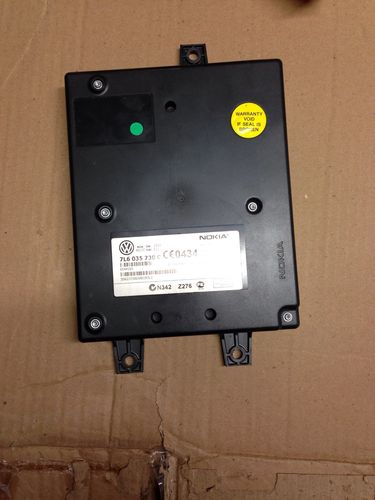

Hi all,
Picked up an OEM Nokia bluetooth module and harness including a mic to plug into my Columbus (2010 VRS). No luck getting the system to work; do I need to have this VCDS coded in?

It doesn't integrate to the car.  It hooks off the quadlock cabling at the back of the head unit to get power and feed voice to the speakers if you haven't got an external speaker for the unit.
No coding, no maxidot.

You have stated that you have Nokia Bluetooth?  Nokia doesn't integrate with the car whatsoever.
Mine came from factory with Bluetooth and the columbus was aftermarket.
If it isn't Nokia and is OEM then it would need coding in VCDS.

I purchased this OEM unit:
...which is on the Ross-Tech table stating it requires coding.
When I plug it in, the telephone menu works (opposed to just muting) but I cannot go any further to attempt to connect a device, so it has clearly detected and communicated in some fashion to the head unit. Could this be related to the aerial plug in the unit itself? Do I need to buy an additional part perhaps?
They generally work without initial coding although I haven't seen that particular unit mentioned much. Have you tried pairing your phone to the unit from the phone menus? Perhaps it is like the earlier 5N0 units and only connects via RSAP, so the type of phone may be a factor?
Unfortunately, I can't pair the phone (Iphone5) the phone can't find the system, also tried an older Sony Ericsson, no joy.
Perhaps then maybe it is an rSap only module as these won't talk to an iPhone. The Ross Tech site doesn't say for this module unfortunately so maybe worth investigating with the seller?
Fecking Nokia......it's either locked down tighter than a camel's arsehole in a sandstorm for rSAP or is potentially broken. I'll pursue a return methinks and get a newer one.

I'm confused, is it Nokia or Skoda?
Thanks for the help.
Blame VW. Nokia simply built what VW ordered
