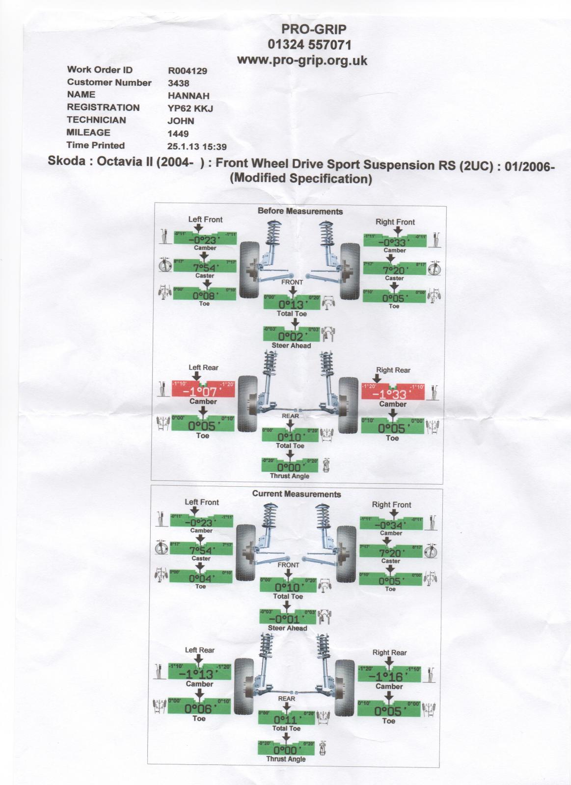

Your rear toe needs to be adjusted but the camber is still someway off. Print out my results and take it with you, they should be able to achieve similar results. Also, why is the Castor greyed out?
Can you adjust the castor on a basic VAG/ Skoda ?  I thought you had to buy upgraded Bushes....
Car is lowered so more negative front camber will occur. Rear camber us fully adjustable so is pretty much where it should be.

Here is my print out below.
