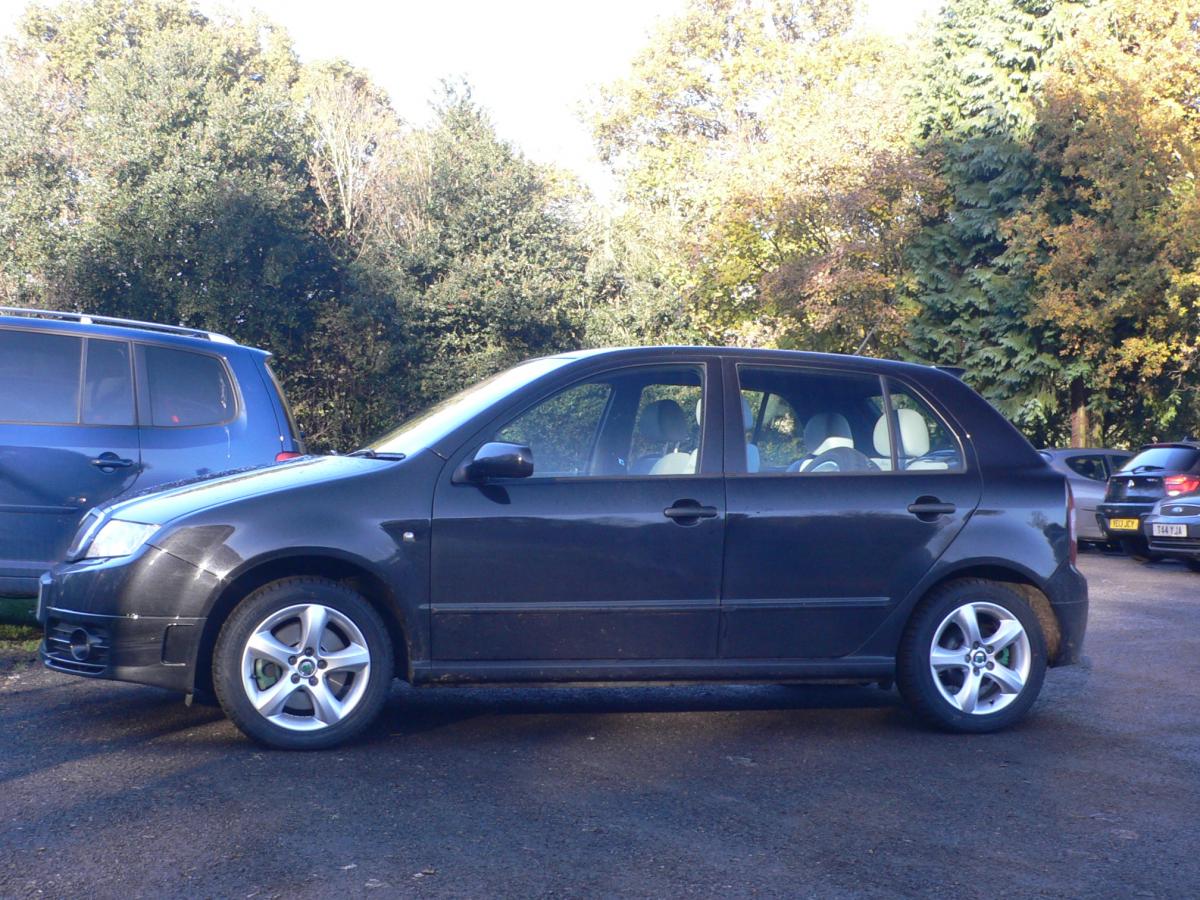

Post a pic of your car :)
We should be able to tell from that for you!

Picture as promised ...
looks standard height
If you can fit your shoe between the tyre and and the arch, it's too high! Standard setup does make it look like it should be a rally car though

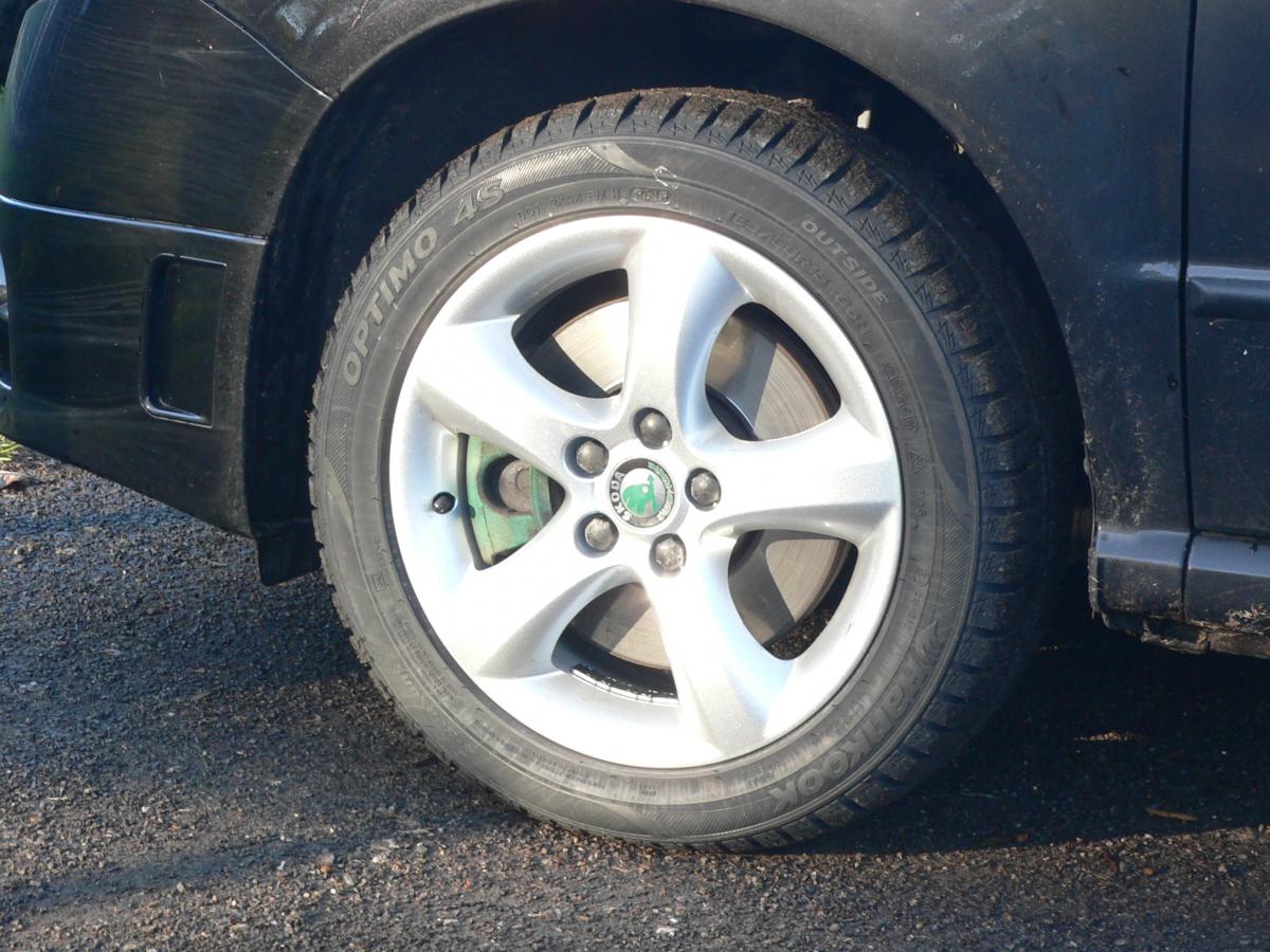

they look like 15" rims to me, std 288mm brakes and they are almost touching the rims.
Probably why the geo is up the spout then. They are probably narrower
tyres as well. Someones been tinkering to the detriment of the OE setup.

Smaller wheels fitted yesterday, for the winter, using all-season tyres in the correct size to allow the use of snow chains, (as per Skoda recommendation). It was difficult to find weights of Skoda oem alloys but these were lightest I could find.
Standard wheels have horrible and mismatched tyres so are off for at least the winter, but tbh having lighter wheels & tyres is a complete revelation and amazingly better, and I'm left wondering if there are any good reasons for using the standard size.
An additional benefit is that we now have a proper full size spare that can be pressed into use if necessary and used up to full speed for the sake of 15 minutes interruption.
Absolutely cracking in the wet, btw ;-)

Came with standard 6.5Jx16" wheels, 205/45. As of yesterday morning replaced with the ones in the photo, 6Jx15" 185/55.
The need for being able to fit snow-chains may be a red-herring, unless we go driving where there is deep snow, but it is the (only) alternative size that Skoda specify for the vRS, and which coincidentally allows the use of snow-chains.
The most worrying aspect was whether the wheels would clear the calipers and leave enough room for sticky weights, which they do, just. However these are Skoda wheels, albeit for the Mk2, so I shouldn't need to have been concerned. The parts chap at Bickerton said the hubs, etc. are the same on the Mk1 and Mk2, so he was certain it wouldn't be a problem
FWIW good quality all-season tyres aren't available in 205/45R16 - Camskill show none, and mytyres don't have anything decent. The choice for good quality winters is limited. The smaller size allows a greater choice, potentially cheaper, although the load index restriction narrows things a bit.
It seemed like a good opportunity to follow a less well trod path with the hope of getting something a bit lighter and less stodgy on the road. A mad experiment, if you like, but with standard size wheels & tyres as a fallback.

Gareth, the arch gap looks pretty standard (about 45mm I think. Sure I've read this somewhere in the past).

For completeness ...
A wash wouldn't go amiss ... ;)
