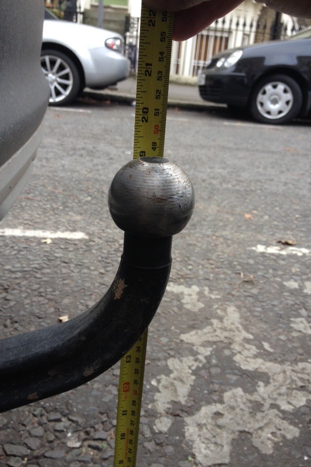

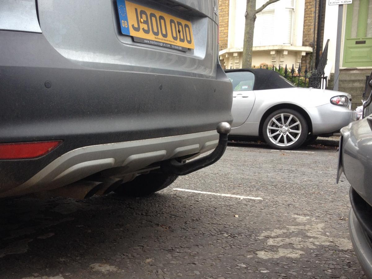

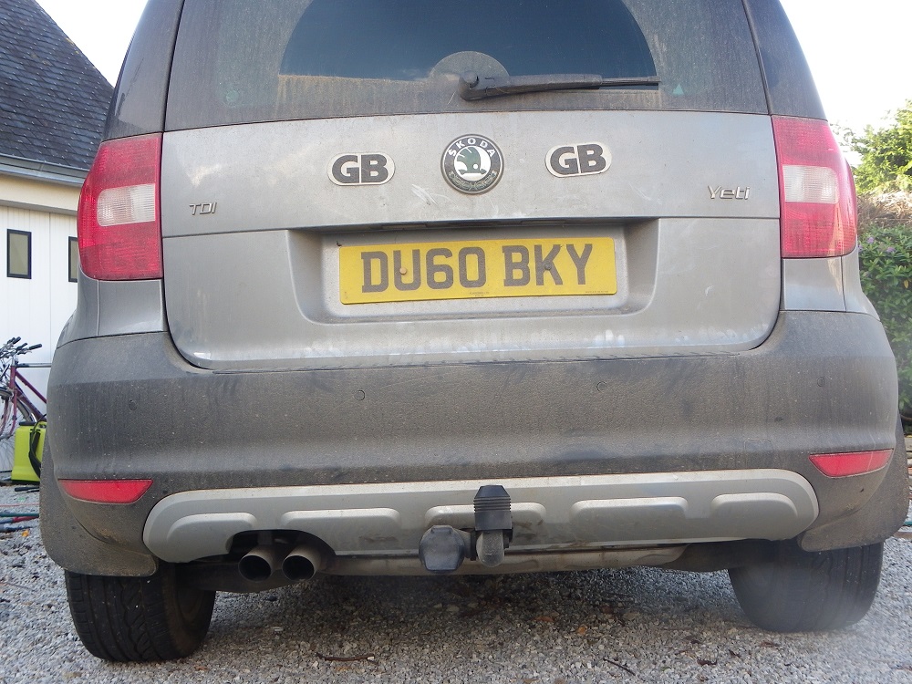

It's still bugging me how my caravan sits so pronouncedly nose up when attached to my dealer fit Westfalia towbar. Can someone with a new Yeti please measure the height from the ground to the top of the towbar? Thanks.
Mine is 485mm.
I'm just wondering if Westfalia might have changed the design in the last three years.

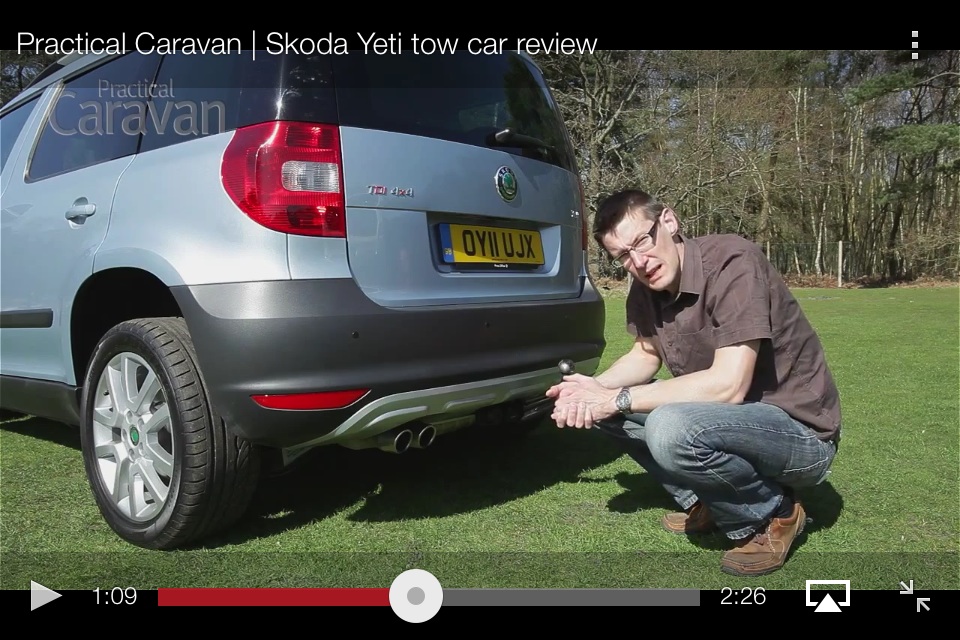

Looking at towing videos of other Yetis I can't make my mind up if they are the same or not.

  • Just measured my factory fit Westfalia - I'm actually getting around 495mm to the flat top of the ball, though the road is a bit uneven so it might just be the same as Johann.   What's this EEC dire
  • Keep it to 80Kg ... and obviously when you get your new van it will probably ride level     .... again I shall predict that happens within the year!
That does seem a bit high even allowing for suspension drop.
Just for comparison my ball height to top of ball is 430 mm which is on top of the jaw on a Witter detachable.
EEC directive states it should be between 350 & 420 mm.
That does look at bit high, Johann!!
I'm trying to work out a possible reason why, but other than something being bolted together incorrectly behind the bumper I'm stumped.

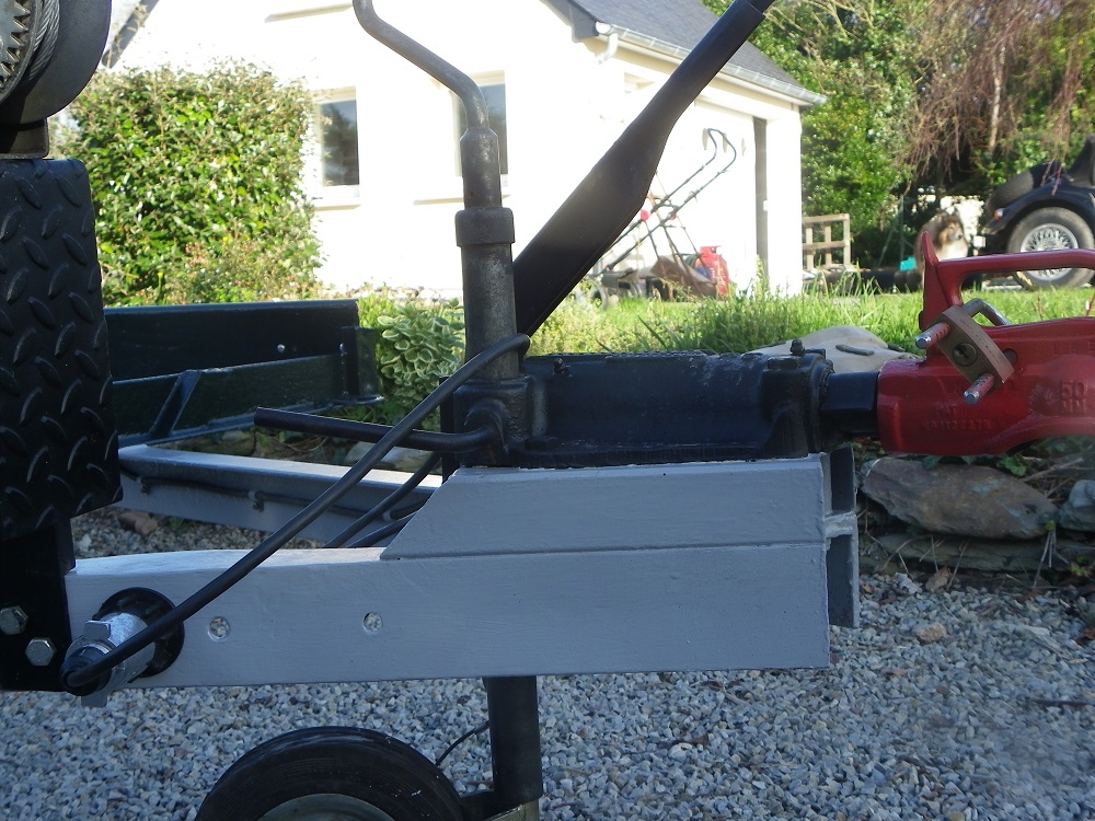

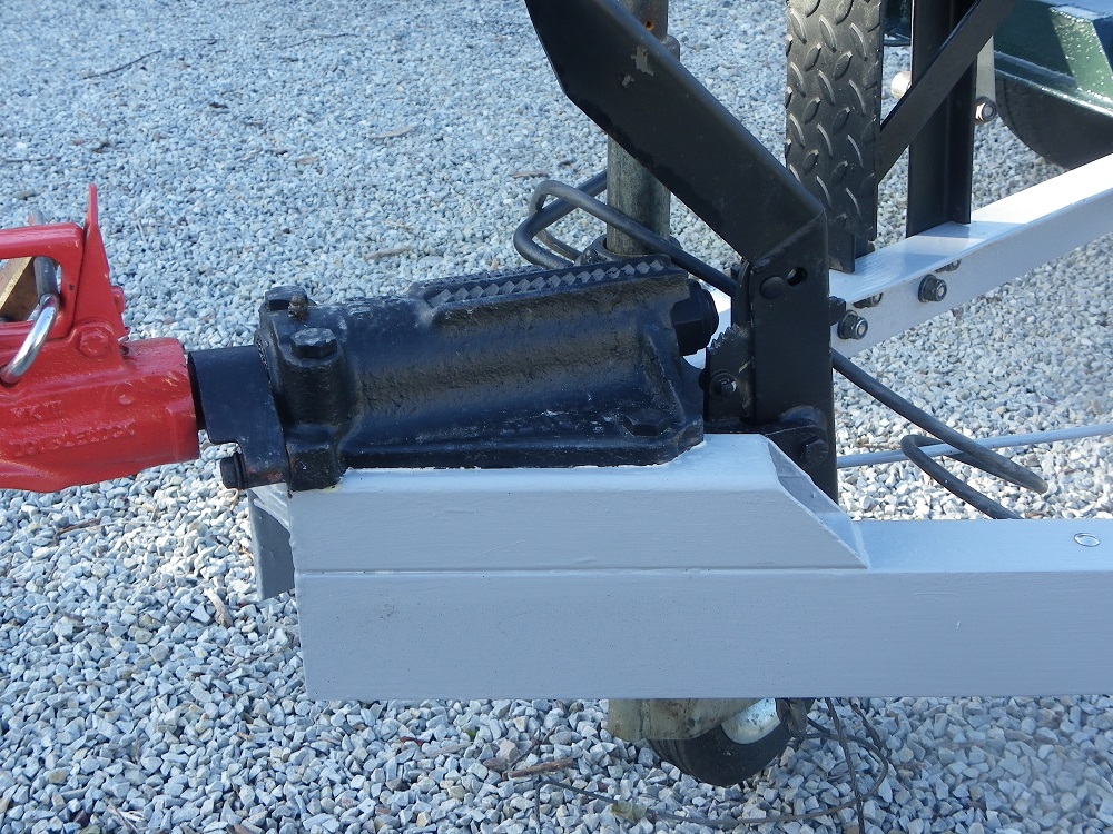

Mine is a fixed Westfalia, difficult to say as my drive is pebbled but to top of ball 460, will look again tomorrow when on a flat surface. looking at it from the rear, the ball top seems to line up with the crease line on the silver part just down from the junc with the grey bumper! hope that helps  -  have fitted a substantial 50mm square tube to raise the hitch on my car transporter to achieve a nose down stance - photos if reqd!
'a substantial 50mm square tube to raise the hitch'
That is the part I am looking for to fit on mine.

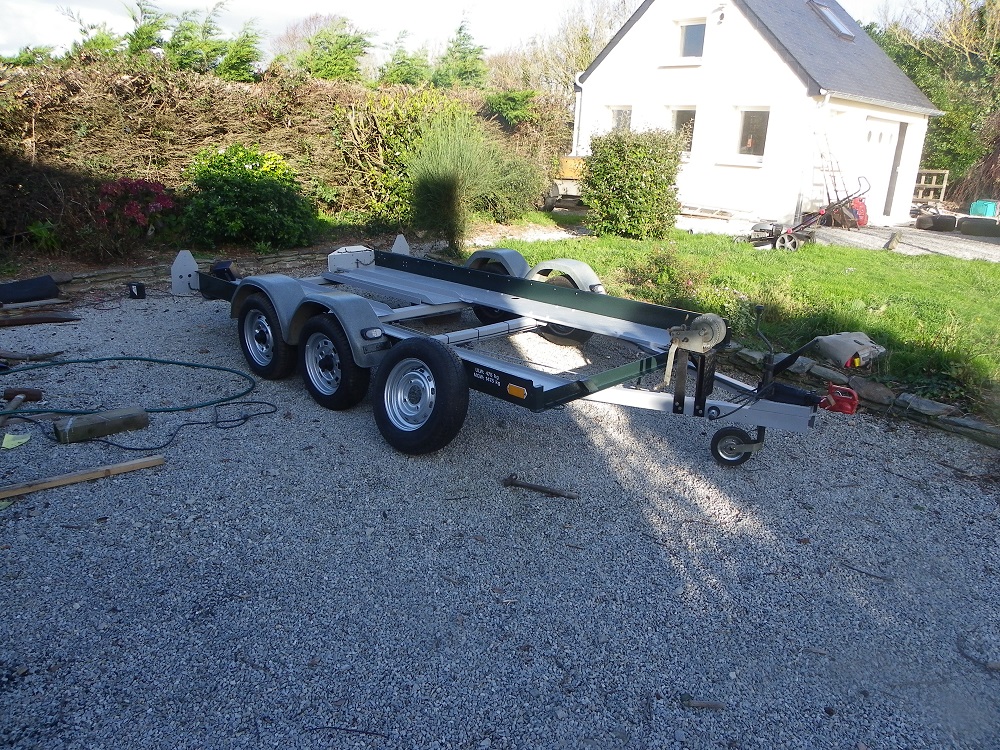

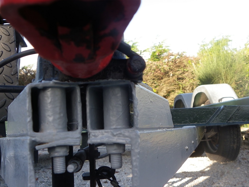

post-73291-0-04741400-1385904768_thumb.jpgpost-73291-0-71303000-1385904778_thumb.jpgpost-73291-0-93186500-1385904789_thumb.jpgpost-73291-0-23187300-1385904802_thumb.jpgpost-73291-0-00036500-1385904819_thumb.jpgLocal steel stockholder/welding shop, I bought a piece 1m long 4mm wall thickness and a piece of 25mm diam tube to make 4 x internally fitted spacers, wall thickness of tube 3mm - total cost here a la frog 10€ used a an angle grinder to cut the sq stuff and the round tube however i also have a lathe which was used to level up the spacer surfaces!
Conversely the towing aspect of my IWT P6 trailer is perfect, suspect the wheels of the transporter have been replaced at sometime as i have 2 MATCHING PAIRS - johann maybe the wheels are smaller than should be fitted, or could be the aspect ratio if its an older van bwhen 100% aspects were available!!

In that case my 485mm to the top sounds dead right and at the top of the allowable range. Hence all Westfalia fitted Yetis should be the same. I appreciate that a Witter or fixed will be different hence asking the question specifically related to the Westfalia.
My caravan must thus be the culprit. :happy:

Just measured mine and it is nearer 500mm - ground to top of ball. This was fitted by dealer at the beginning of November on new purchase. It does seem high but as I'm only towing small trailer didn't dwell on it.
if you get the wranglers and they dont work gimme a call they might fit my other car! Joking apart my transporter was fitted with 100 aspect tyres on 13" rims, it dates from the early '80's, 100 aspect tyres were the norm back then, but are now like rocking horse droppings and the nearest I could get were 70's, which on a width of 165 x .7 for the wall gives just under 50mm less on thr radius, which is the almost exact height i have had to raise the hitch!
