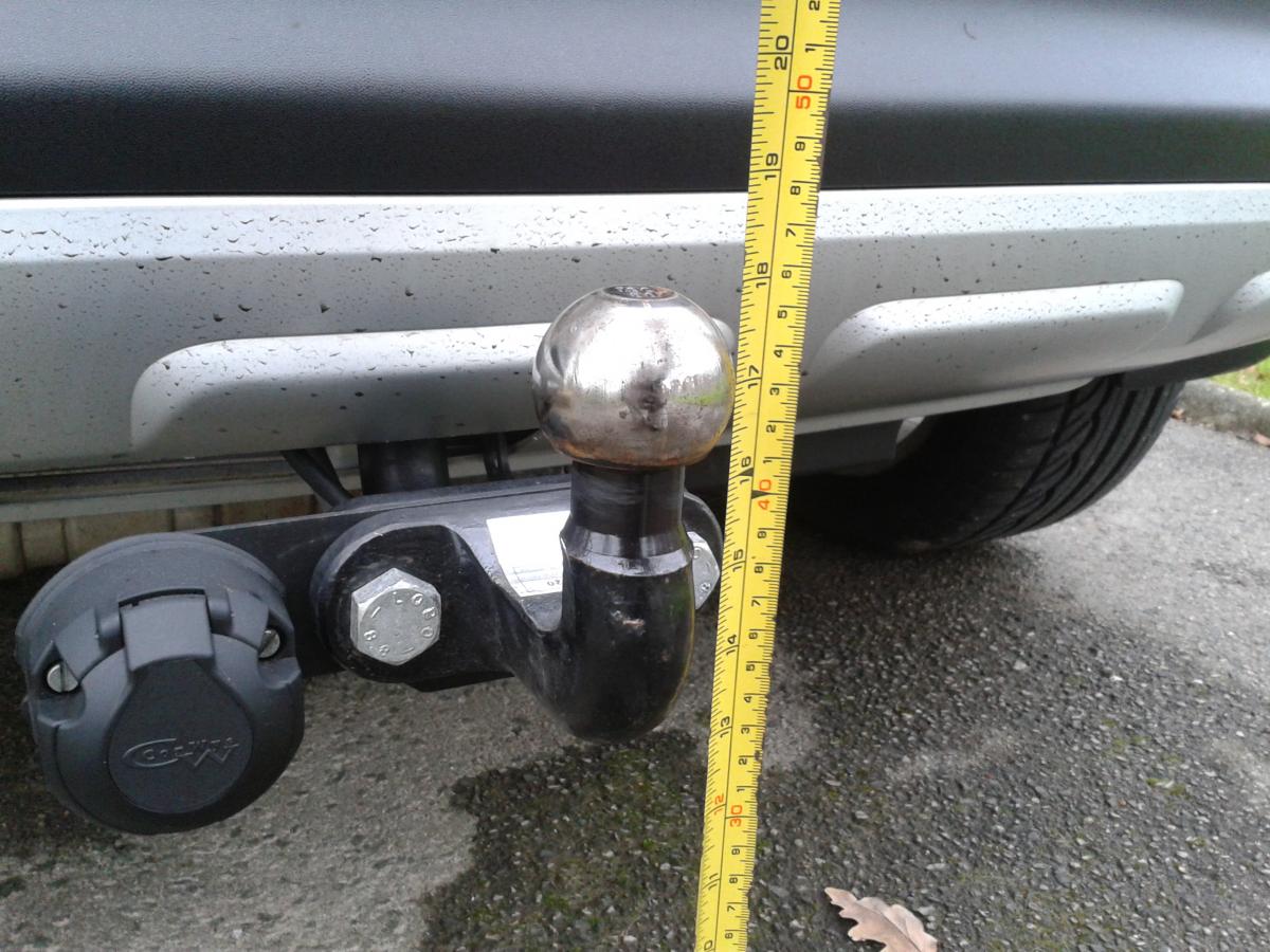

Height to top of Westfalia detachable towball
FYI. My 2012 Sterling rides very much nose down with the car and caravan fully loaded.

  • Just measured my factory fit Westfalia - I'm actually getting around 495mm to the flat top of the ball, though the road is a bit uneven so it might just be the same as Johann.   What's this EEC dire

That is about 10mm high.
EU Regs suggest max should be 420mm to centre of ball.

Oh the unit is steady as anything when towing. I don't have issues towing it whatsoever especially after fitting the Winterhoff. Just want to be sure in an emergency stop everything will be fine... Nothing I can do about it apart from moving weight around since the £834 towbar is NOT getting changed nor is the caravan anytime soon.

I wonder....  If a Westfalia removable towbar from something else like a Touareg will fit:
http://www.youtube.com/watch?v=oEJ72kW6W7o
I think the Touareg's points down too much as it is MUCH higher, but the male-female fitting seems to be the same for them all...
Or a Golf V?
http://www.youtube.com/watch?v=X1LLug-JItU
Mercedes C-class?
http://www.youtube.com/watch?v=9tRIqPepj_c
But I guess I should look at SUVs...  that sit higher and have something between what the Yeti's is and that of the down-pointing Touareg.
I do remember someone who was having stability issues with an SMax (I think) had his removable ball replaced by one of a different shape (I guess giving a lower final height) by the towbar maker.
Can only remember sketchy details but maybe it is worth talking to Westfalia about the issue.
I think...  well I wanted to get the thing delivered before I commented, but I'm too excited...  but I think I found the solution.
A VW Tiguan Westfalia tow hook!  After watching those videos above I found the Tiguan one and it looked perfect.  Then looking at the Westfalia installation manuals they look like this:
Yeti:
Tiguan:
Two images above combined:
Then I went on eBay to see if I could find photos of a Tiguan one and low and behold I find a 2010 Tiguan Westfalia tow hook for the princely sum of £20 plus postage!!!
I'm 95% sure the male part of the fitting at the top is Westfalia universal and will fit in my Yeti.  So I think this might just drop my towball height by 80mm or so.   :rofl:  :rofl:  :rofl:  :rofl:  The rounded towball part is about 40mm and looking at the images above it visually drops it by two towballs or so.
Proof is in the pudding and I'll know once it arrives.  I might just end up with a big heavy paperweight but I do hope not.

Perfect fit!!!! And a drop of just under 75mm as predicted. I'm happy. Not sure how big a difference that will make on caravan but it can only be better. So to the middle of my towball on my car should be around 380mm now.
Also look how parking somewhere different can change the dims. Today the Yeti original measured 477mm vs 485mm parked on other side of road. The after dim to top of ball is roughly 400mm.
Before and after:
And side by side:

No I have the correct original setup. The Yeti setup is just at the high end of the official EU range. And my caravan at the low end. So the combination was a bit out.

I've just managed to get a look at my hook, although couldn't do a test fitting for heights.  Definitely as Johann's at left above (ball just above top of mount); the forging is of slightly different pattern but the stamping number is virtually the same - 5L0803882 (plus another group - mine's 8/11 or 9/11).  Supplied with new car September 2012, and 'van (2005 Elddis) runs level.
