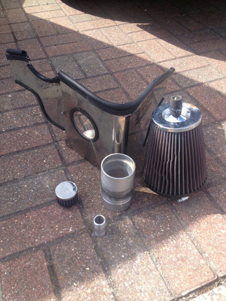

I'm putting together my own jabbasport type induction kit and I'm wondering if anyone knows the size/dimension of the 2 alloy pipes. The smaller one is the most important size I need right now.
PIC uploaded below, used it from a selling thread.
Sent from my GT-I9505G using Tapatalk
Hey my old kit lol
The inside was machined out to go onto the 63mm maf
The small iirc was 25mm tube that would take the breather filter
U could get a 63 od alloy joiner on ebay or forge
Then get a 63mm id joiner snd do it that way bud

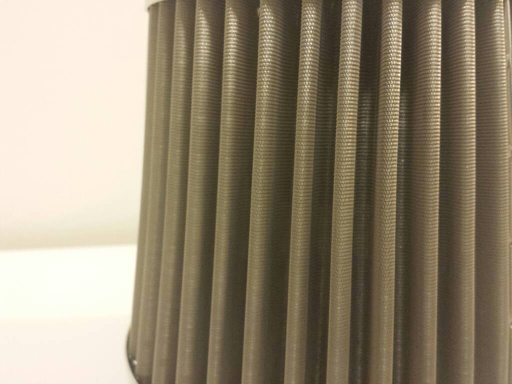

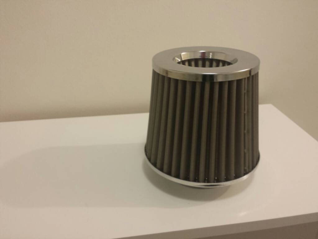

Have a silver stainless filter with rubber neck. Comes with various size necks so should be OK. Its a bit ripspeed ish but will do until after Xmas and I buy a jetex.
Is that the powertec ones ?
Same design. Cheap ass make tho!
Couple of pics. Doesn't feel as cheap as it looks. Will do for a wee while.
