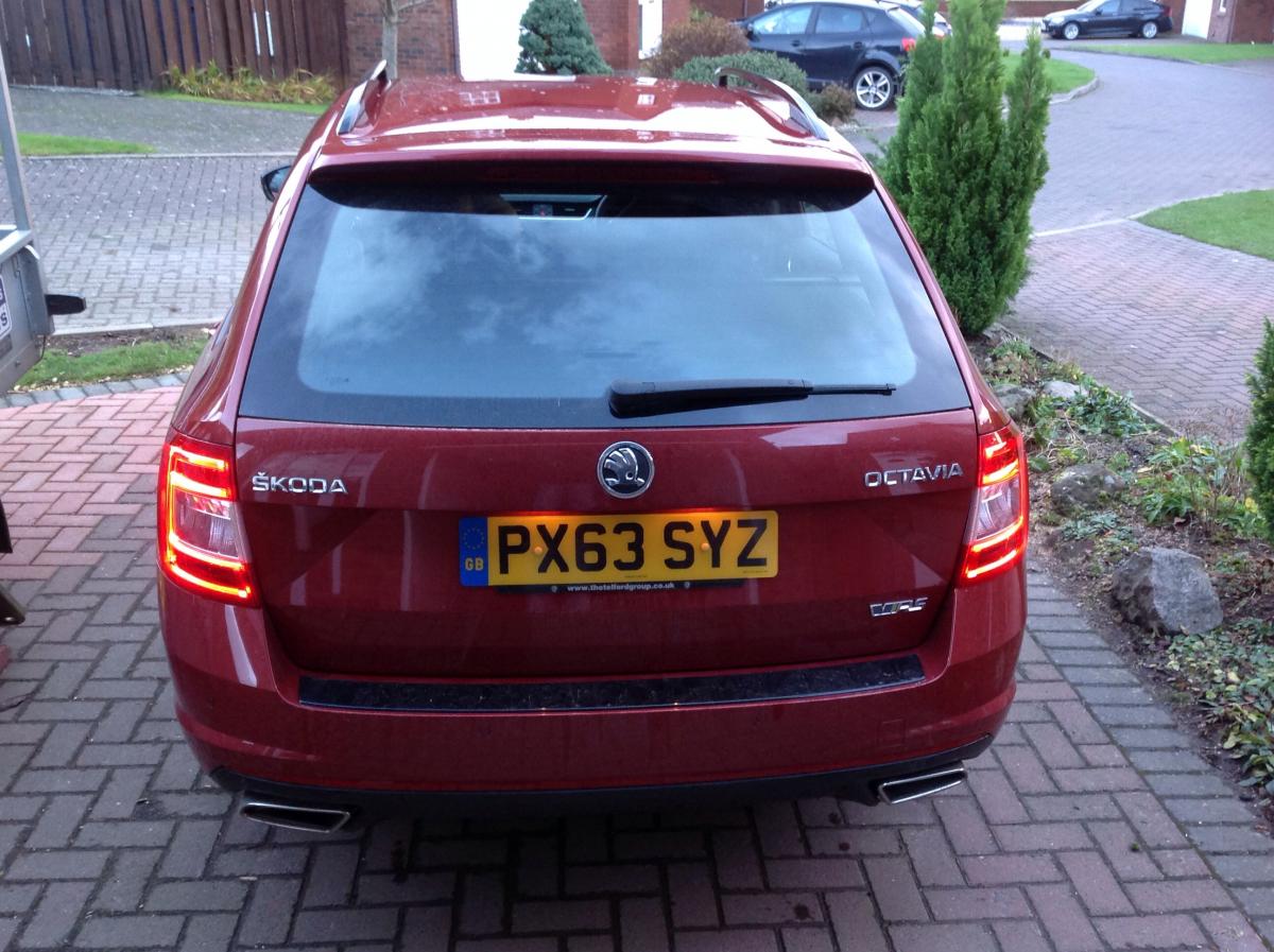

Here's the car without the tow bar:post-106713-0-93953600-1387877280_thumb.jpg

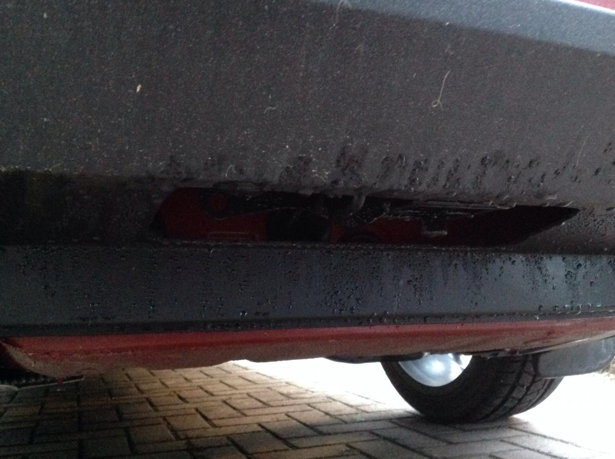

And the underneath of the car without the tow bar, i.e. the fitting area:post-106713-0-18552600-1387877332_thumb.jpg

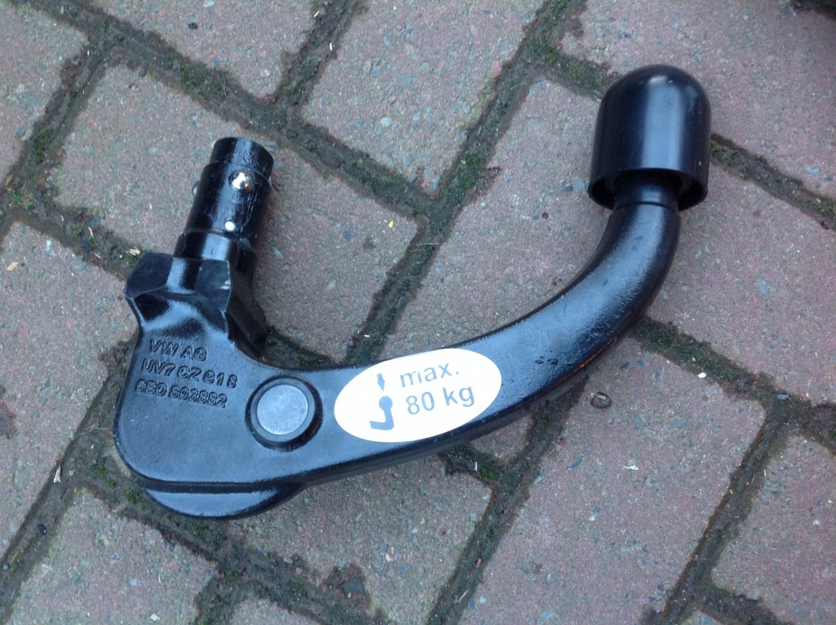

Now the tow bar itself, it's a VW unit:post-106713-0-91894000-1387877450_thumb.jpg
And finally the tow bar on the car, as stated earlier in the post, the electrical hook up drops down from underneath the bumper, so it all looks very neat when not in use:post-106713-0-83635400-1387877527_thumb.jpg
Not in need of a tow bar myself but that is a very neat solution, is there a cover that goes over the hole in the bumper or is it just left open?
It's left open, but you can't see it and as it's been done by the Dealer I have a full three year warranty on the work. There is a removable plastic cover that sits in the hole where the tow bar goes to prevent detritus getting into the fitment area.
In addition I read the installation manual and there appears to have been quite a lot of protective gunk applied to the relevant areas, so I am happy with my choice!

Great photos, thanks. Does the towbar have a lock, my old Mk2 has a securing/locking arm to hold the swan neck in place, this in turn has a lock on it to stop robbers/pranksters from taking the swan neck section.
