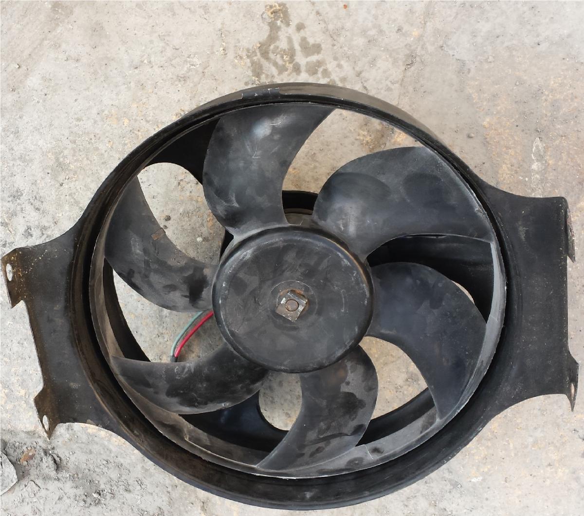

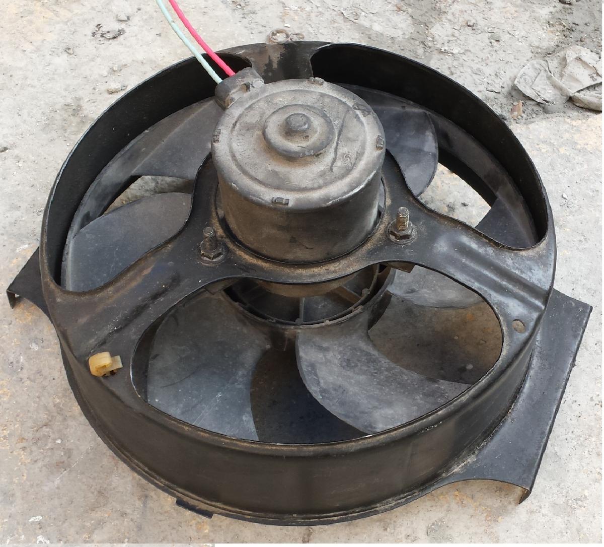

The problem was that the combi did not have a radiator because it had already been sold... so i used the one that my car had. which means that while i was wiring the fan, i switched the fan's polarity and it was pushing instead of pulling.
I had already noticed the air flow but it passed through my mind especially since i had found 2 bolts that where loose from the cylinderhead making me think that the head gasket was blown.
Edited by warbuli
Anyways here is now the new fitted radiator fan! :D
In my opinion its a better radiator fan too because it pulls more air.

basically i had observed it before and i checked it with the new fan that i had... that is how i found out the direction of the air flow..
