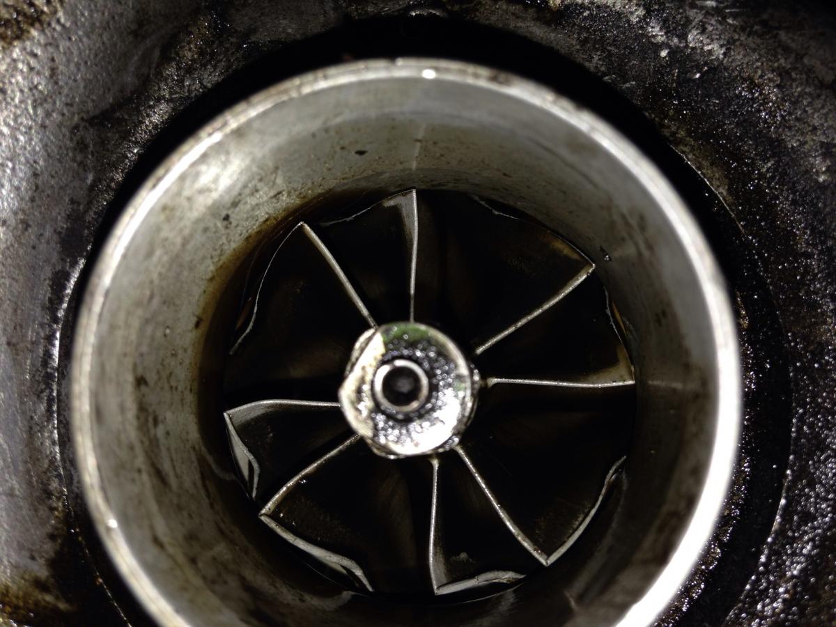

Drivin the whip on on Thursday was making my way through traffic on a B road bashing when the car went sluggish and wasn't making any boost so pulled over and had an instant smoke screen lol

Check for why its failed !! Oil pressure issue etc etc
Normally another reason behind these failing like that
Tbh as soon as it happened I was watchin my pressure and temp gauges like a hawk incase there was a serious problem but all was normal .. I was planning on changing the oil pick up and return pipe next service as a precaution before this happened . It's had a compression tested and alls well plus dianogstics showed no fault codes other than expected so maybe just a knackered turbo ?? It's done 130k nearly and found out its a 2nd turbo that's coming off still got writing on the exhaust manifold lol
Surely that would indicate that there might be something up with oil supply or return?
Mine is on 130k miles and still on the original turbo. But it could be just normal failure as you say.
it is definitely worth giving the oil lines a good looking over anyway.
When I bought the car I thought the turbo looked newer than it should for the mileage and age and I can tell from the condition of the pipework throughout the engine it wasn't looked after before I had it . I've replaced most things over the two years I've had it and had planned to changed the oil pick up and return pipes on the next service which was gonna happen end of jan . Will have a butchers at the old ones comin off see if there's any obvious signs that caused it . I do remember heck in for play in the shaft over a year ago when I fitted a tip and there was play then so takin it stage two mite had something to so with it lol
ha, there you go, that was probably it!
Hope it's as you say, due to a stage 2 and not because of oil supply / pressure issues. As you know, the pickup does get clogged on these. Low oil pressure is death to a turbo bearing.
