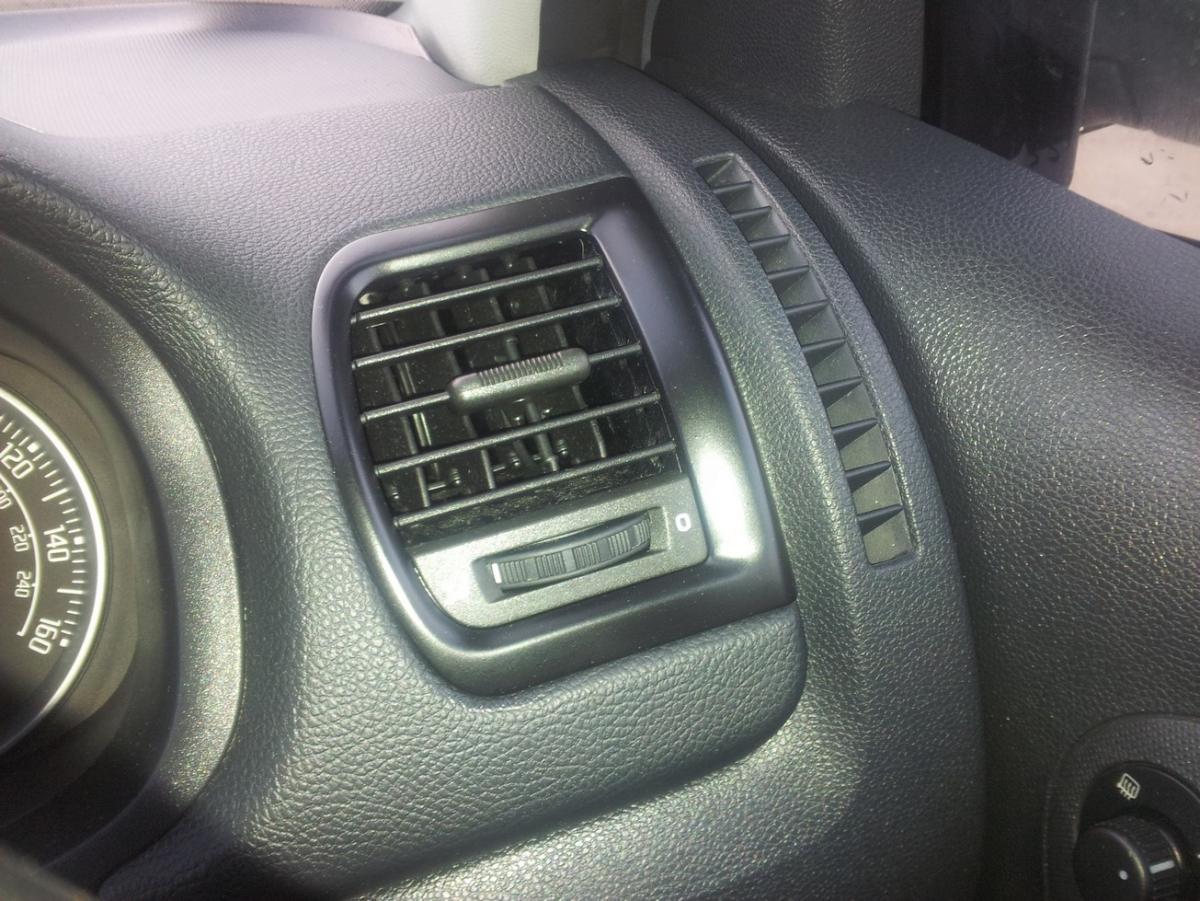

While I had the vents out of the car and in pieces, I thought it only right to try painting them satin black to cure the reflection problem. I cleaned the parts and applied a plastic primer before top coating in satin black.

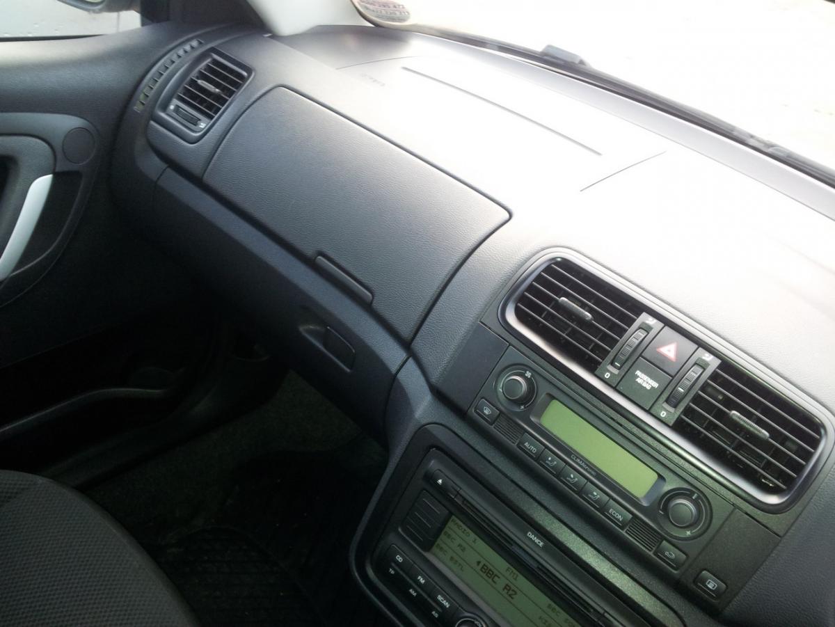

This was the result: (you can see the original silver colour on the door handle)
The hardest part was getting the centre vent out of the dash. I'm sure I broke parts of it and ended up glueing them back together.
It seems to have cured the ugly reflection problem I was having and toned down the cheap silver on the dashboard.
