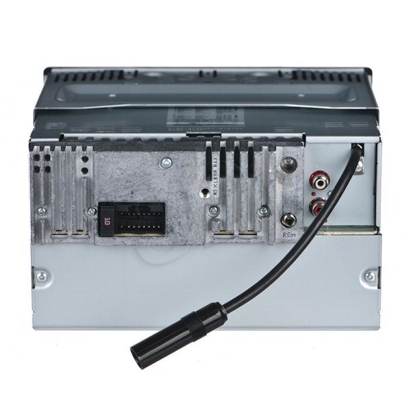

Do think i will need an ISO to Din Radio Ariel Adaptor if i am fitting this?? - http://www.halfords.com/webapp/wcs/stores/servlet/product_storeId_10001_catalogId_10151_productId_869197_langId_-1_categoryId_165655

It's hard to say Harry. I can't seem to find a picture f the rear of that unit online to see what the Ariel connection is like.
Found one. Yes you will need an adaptor Harry.
Thanks for the help, i'll order one right away :)
