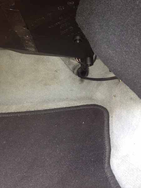

On the mk1 Octavia vrs there's a grommit that can be pushed through on the firewall, on the front passenger footwell
do you have a pick of it cant find a gromit anywere
There is one under scuttle panel drivers side near the fuse box. Or more easier to get to is remove glove compartment and behind that up near where carpet ends is a grommet
I shall upload a pic by afternoon sometime :-)
That is the front passenger footwell, just above the top right corner of the mat :)
