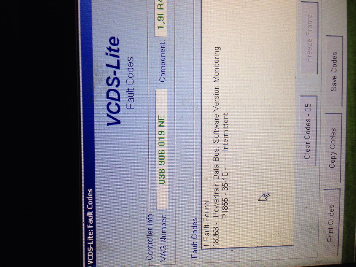

you've got me wondering now, did I or didn't I use AutoScan. :doh: I'll try with a FULLY charged laptop tomorrow :D
always comes in handy. Im literally sitting waiting for the blasted thing to charge!
Shame VCDS doesnt work on Macs
This is the fault
