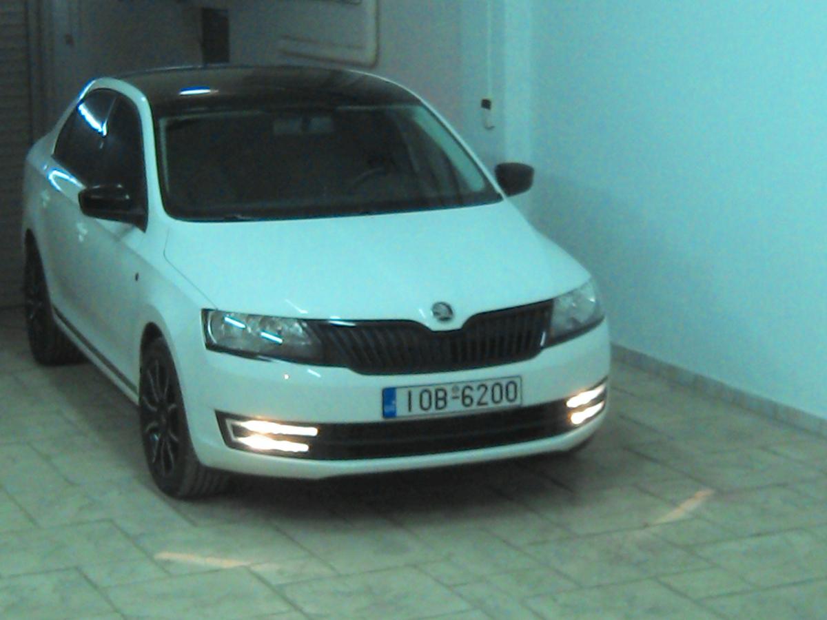

I appreciate this is a Rapid and not a MkIII Octy, although it's hard to tell (just kidding!) but this member has turned off the DRL's in the main headlight and set the fog lights to act as DRL's instead.
It would appear that instead of reducing their intensity he has applied black tape over the lense...
