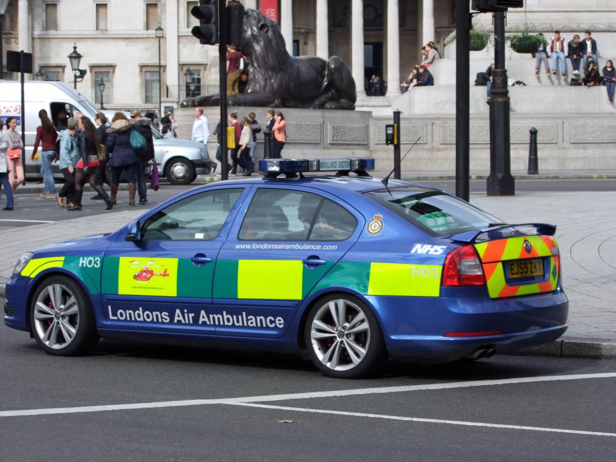

Gotta be the vRS. ;-)
Edited by Furbytom
I know that both Ambulance and Police (dog section) rate the scouts. They are fantastic for the job - Police are slowly introducing the Yeti in 170bhp and these are also highly thought of...would this not be a possibility for you? Seen a couple of Doctors ones marked up around Cambridgeshire.
HEMS - lucky gets!
