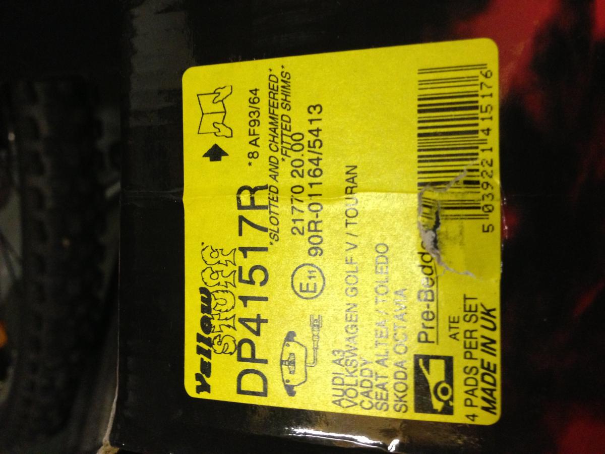

These are what I had and now Sharkrider has on his VRS wagon.
Interesting to see that the packaging says ATE which goes against my pure internet research indicating TRW.  Think this basically means the OP will need to check with EBC or his dealership to make sure that he gets the correct ones, unless there is something marked up on the car somewhere?

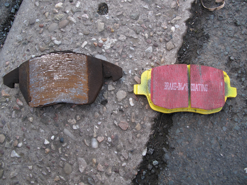

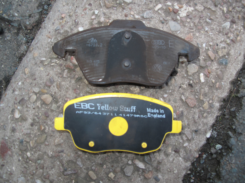

I had a mare finding these pads and had been sent two sets that were wrong before I contacted EBC direct who were really helpful, I emailed a picture of the OEM pads to Brian at EBC and he immediately emailed back with the part number I needed, these arrived the day before the track day I was going to do.
 Pads worked well on track and did not fade, on the road they are also give a good pedal feel, Sharkrider has them now and Korban has them in his MK I Fabia fronts and rears.

The TRW are the wrong pads, see my picture, yellow were the wrong one and black is OEM fitment.

the major difference between trw and ate are the "hooks"
left pic is ate and right is trw
