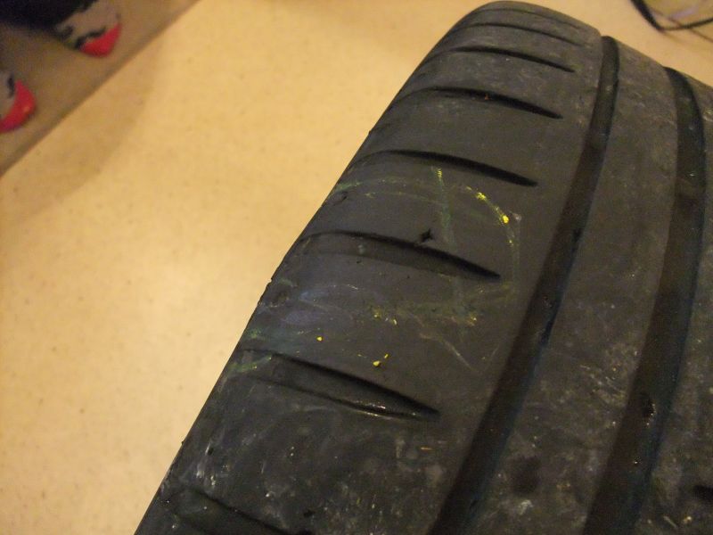

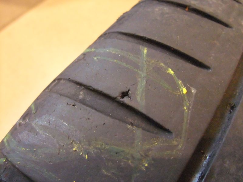

An argument with a pothole last night meant a new tyre today - but fortunately it seems nothing more.
A new tyre also means the almost obligatory free tracking check...  The results were 8 on both sides on the gauges at the back, and -1 and +2 at the front.  Unclear what the units of measurement were, but "degrees" were mentioned in relation to the front figures.  I was told that my car's wheels were supposed to be "parallel" and so apparently the numbers didn't matter as long as the backs were the same as each other, and the fronts were the negative of each other.  I didn't end up get the tracking adjusted, and one of the staff even told me afterwards that he wouldn't have got it done either.

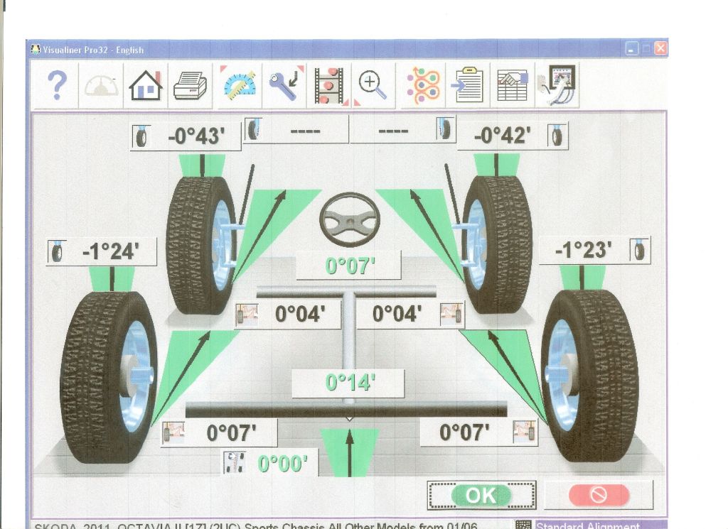

I had my geometry setup by Hunter and supertracker machines. The steering wheel was still out and pulled to the left because of this.
I bought myself a Track ace. As you can see the two results are virtually identical and I can align the rears too.
I think I am going to invest in one of these, it looks easy to use and its small. (I find it really annoying when you hit a pot hole and it puts the steering wheel out of centre and then have to have it aligned again)

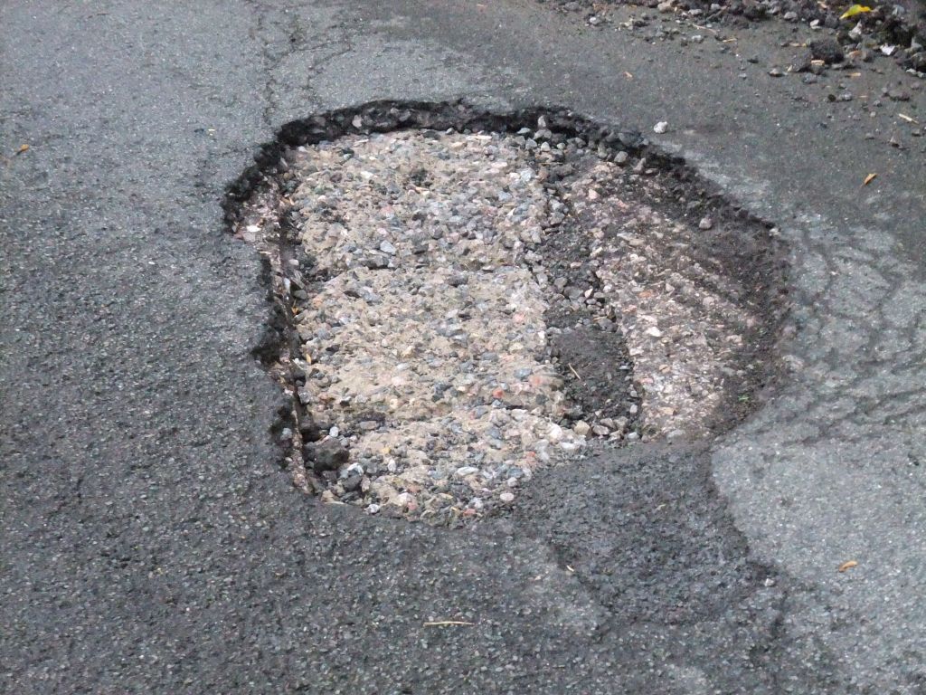

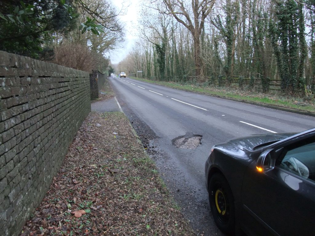

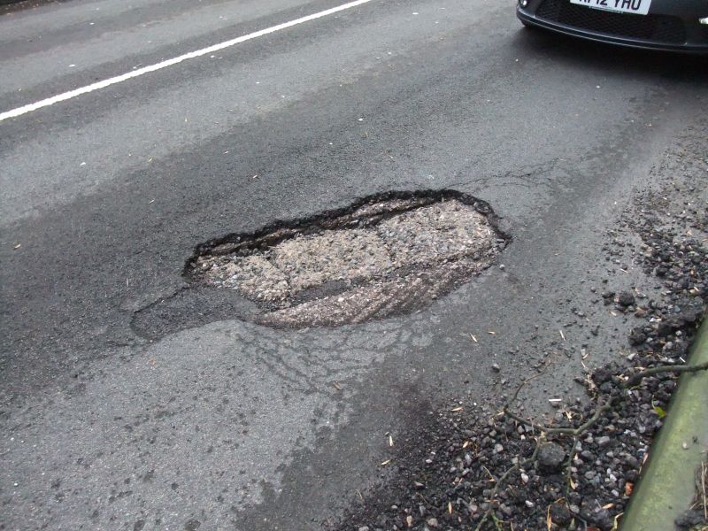

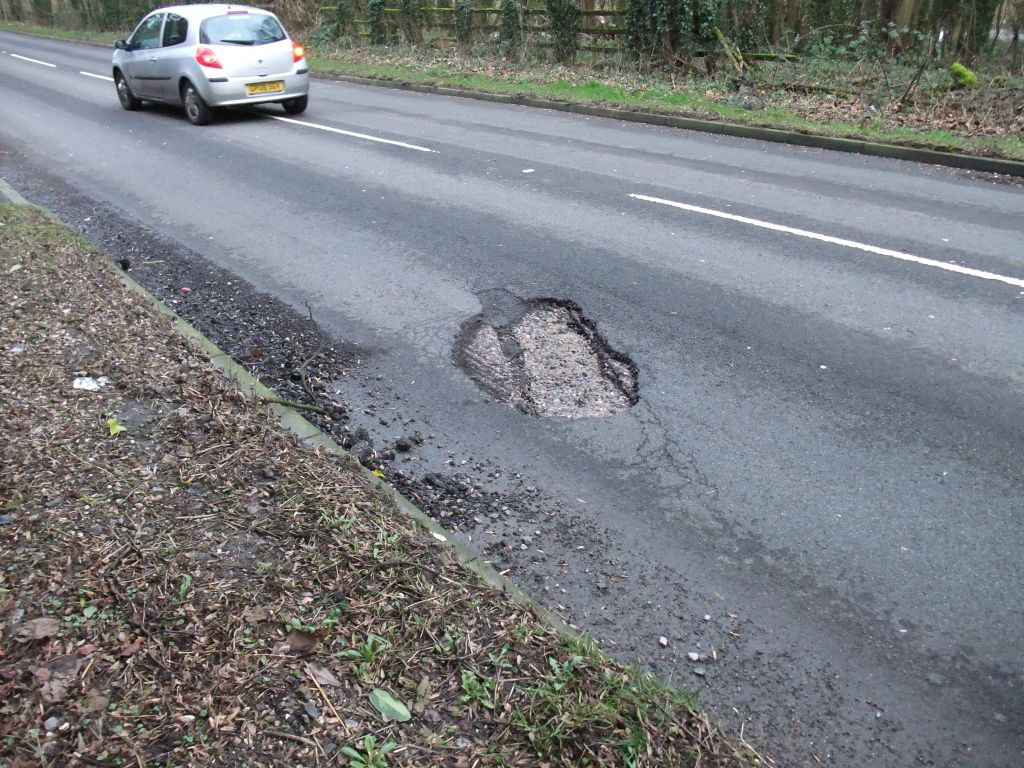

Me too last Saturday afternoon, I don't know about pothole though, its almost the size of a small garden pond ! Off to get two new Michelin PS3's tomorrow and a 3D tracking check. Last hi tech tracking I had done was on the much missed Fabia vRS 6 years ago. Well worth it though, ran a set of PS2's on that for well over 20k miles IIRC, hope it turns out as well this time.
Oncoming & following traffic made it hard to avoid a pinch rupture on the side wall. Fortunately we weren't far from destination and able to fit spare (another worthwhile purchase).
Me too - well SWMBO, borrow my car, 2 tyres striaght away, on a series of potholes, so had to be recovered & a 3rd tyre had a 4 inch gash in it.
Went back with the camera & tape measure (as advised on www.potholes.co.uk), the council had filled them, so nothing to photograph or measure.
