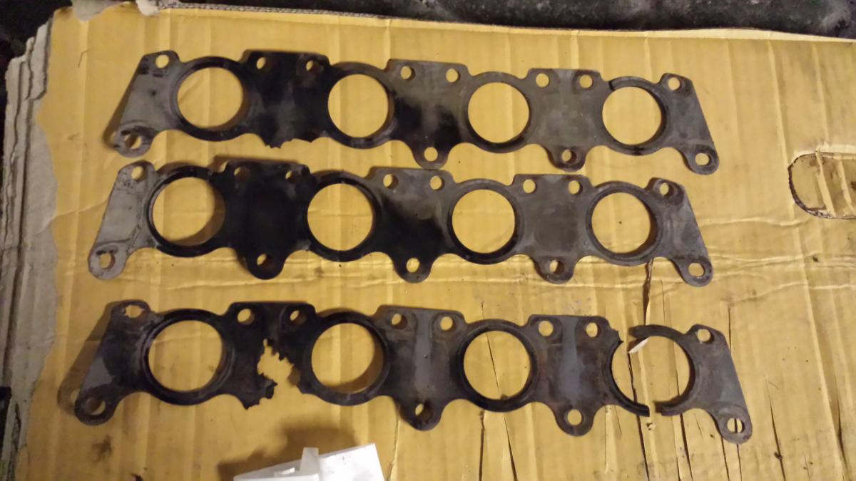

I had this as well. For ~£4 or less from a dealer, it fixed my blowing. I did think it was a crack in the manifold though, especially as I have a spare with a tiny crack on the turbo mating face. This was my gasket after 103k miles. The bolt closest to the head had actually completely unwound itself as well, but thankfully, it was trapped and couldn't physically drop onto the floor. It was a relief to find that it was intact and half of it wasn't left broken in the turbo...
well you've shown me yours so I will show you mine waaaa :-o
this was listed as a ''high performance gasket'' designed to withstand super duper heat ect lol...
this is after only 3days and hardly any miles at all.!!!....
quite shocking for only 3 days use I think you would agree??..! I will be having my money back
That is extremely poor.
Can't beat oem
That's just a cheap **** gasket lol
