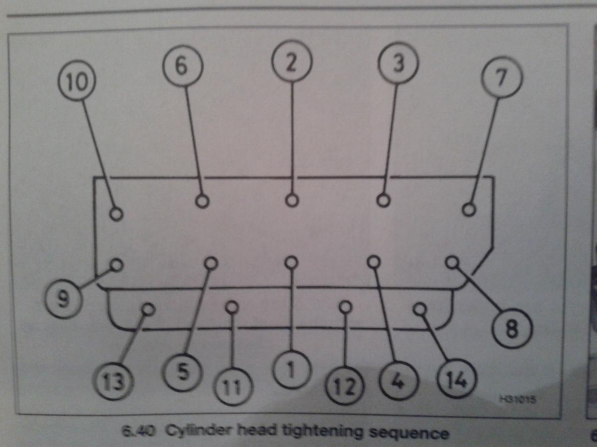

Im wondering about re-torquing the Temac gasket or a HG replacement. On revving hard the engine has a slight and brief whistle/shriek sound I havent yet tracked down. It could be any of the following though so far Ive got no visual inspection proof of anything :
Dry bearing (unlikely)
Passing exhaust gasket or joint
Passing intake gasket
Head crack
Head Gasket
My questions :
Re-torque values? (I believe 20nm then 2 quarter turns is procedure) - what does that make the final nm value for a re-torque check?
Re-torque pattern?
Best replacement HG make?
I know that a skim and pressure test is called for either on existing head or verified on a replacement head, I also know that after this much time a re-torque probably wont help but its worth a try, even if it makes an audible change in the shriek sound.

Cylinder head bolts: Stage 1. 20Nm Stage 2. Angle tighten 900 Stage 3. Angle tighten a further 900 Cylinder head nuts; 20Nm
Tightening Sequence
As for the make of head gasket, I'd just get an OEM one from TPS.
