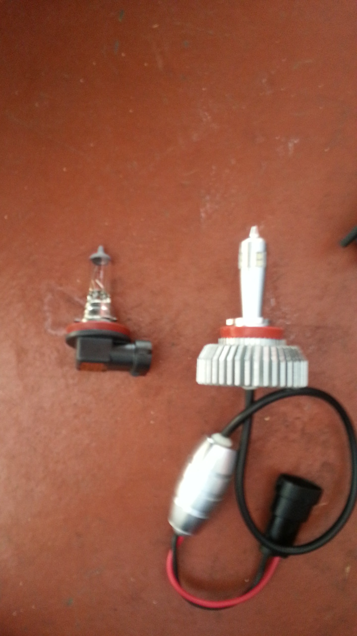

New bulbs installed, they are a LOT brighter than the originals. The colour doesn't quite match the xenon headlights, its more blue (at a guess 5000k). You can see a comparison of the original (left) and new (right).
Also included a picture of the LED bulbs which have a very large heat sink, next to the original bulbs. Got the LEDs from car-mod-shop

New bulbs installed, they are a LOT brighter than the originals. The colour doesn't quite match the xenon headlights, its more blue (at a guess 5000k). You can see a comparison of the original (left) and new (right).Also included a picture of the LED bulbs which have a very large heat sink, next to the original bulbs. Got the LEDs from car-mod-shop
How much were the LEDs?
