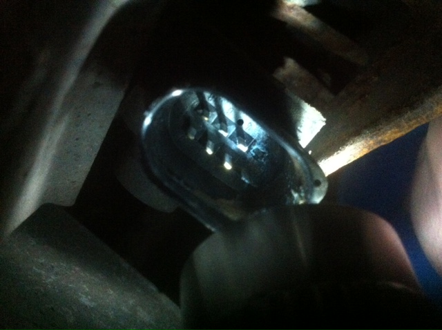

After visiting adamal and still having no luck accessing the module i have had a look and found a broken pin in the connector for the levelling sensor.  Can be seen on the bottom right just.
So need a new levelling sensor, is that the right name for the component? and to remove the pin from the multi pin plug.
hopefully then it will play ball
