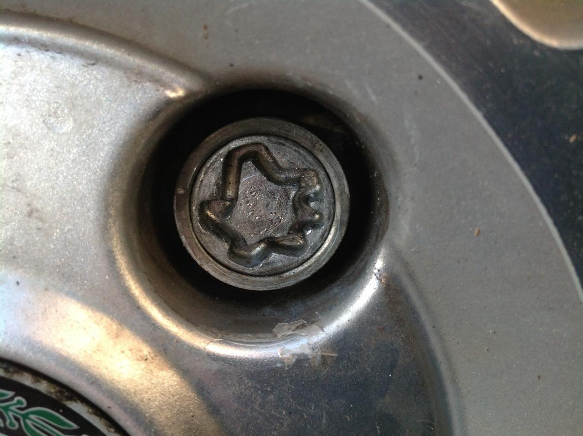

Is your lock nut like this? Mine had the letter H on it . I emailed [email protected] with a picture of it and they identified the "key number". I think in my case it was 276 or something. They supply the keys at a cost of around £15 if I remember right.
Edit: I believe these are the originals from my '09 superb. I think you can't get them from Skoda anymore and have to go direct to manufacturer.
