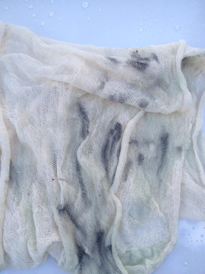

Sounds like wax contamination on the glass to me. A good glass cleaner should remove it, the wiper blades will need cleaning as well.
+1
Give the screen and wipers a good rub down with IPA (Isopropyl Alcohol)
It's easy to get the same problem after going to a £5.00 hand car wash where mr Waxy sprays the whole car with his spray and shine gloss gunk including the glass.
Good for one wipe, by number two and three you have a smeary mess as the wipers get coated too and slide/judder over the water leaving a film.
Will relay the information, Gents!
Thank you!
There's nothing wrong with the wiper-blades or screen....just the dealers' valeters. They don't differentiate between paintwork and glass when "preparing" the cars.
I've found that I have to spend half an hour de-contaminating glass areas on every single new car I've bought.
This is what she got when she cleaned the wipers
