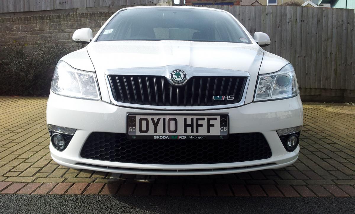

Please see the picture below. That's the result I'm looking for. Nice gloss black NOT matt or plastidip. Can I do it with the items (sprays) you have sent me as an example? If yes, what is the proper procedure? Do I have to use sand paper to take off the chrome coat?
Not done it personally but a lot of folk recommend sanding the chrome back to give the primer something to key into.
Those items should be fine, the black is a gloss black but I don't know just how glossy.
I used "Black Magic" spray can from Halfords for mine as I didn't want matt black either and "normal" gloss such as "piano" was a bit plain. I sanded the chrome off but later found out you can soak it in a bath of toilet bleach to remove it. The benefit of that is the finish ;)
Personally, I stuck it in a body shop after and asked them to spray it as I wanted it to be perfect, something that I didn't achieve the first time round :D
