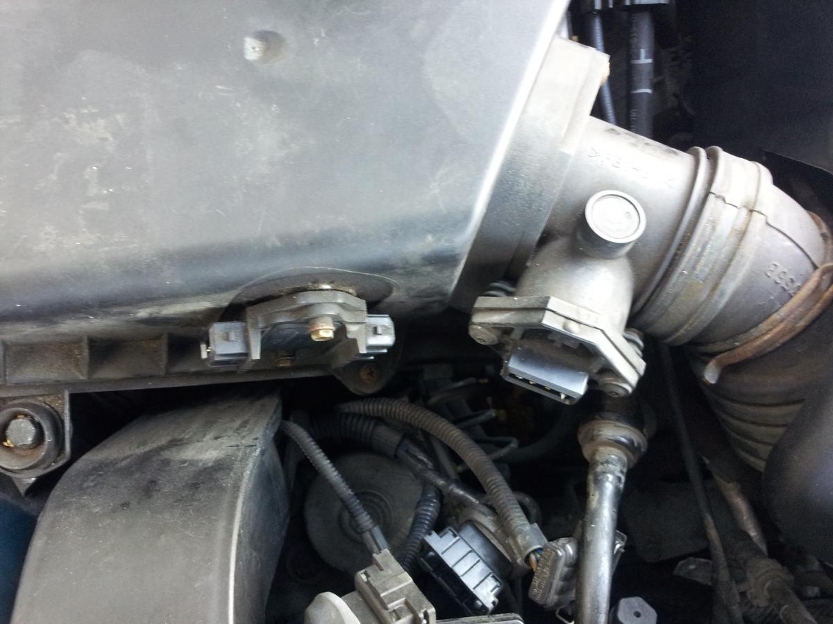

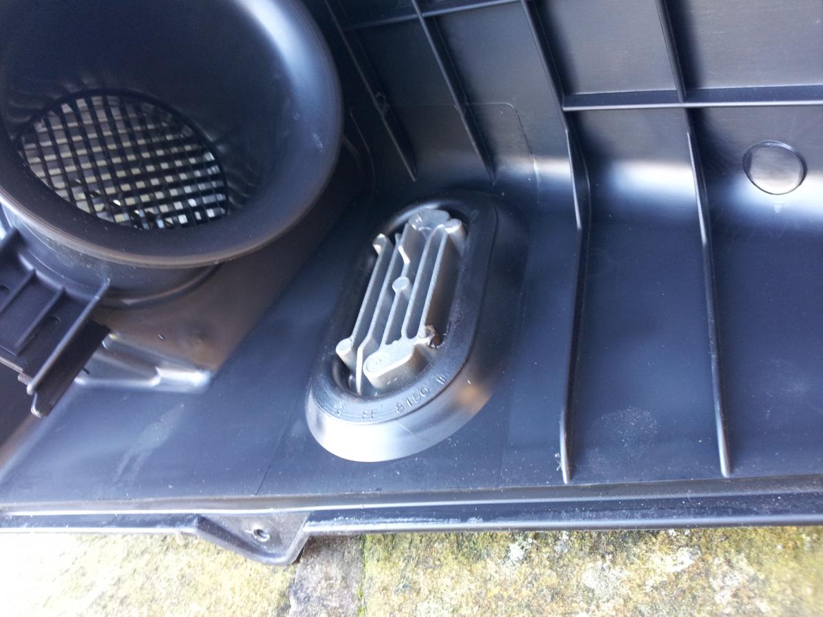

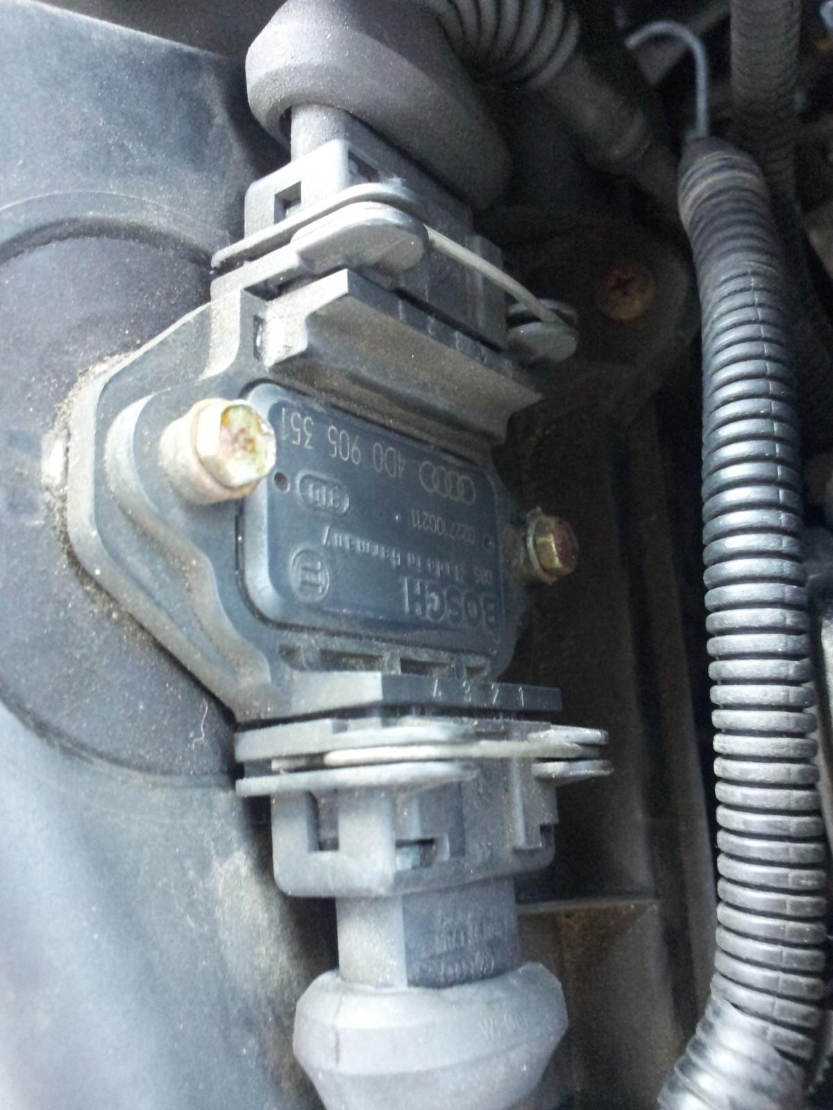

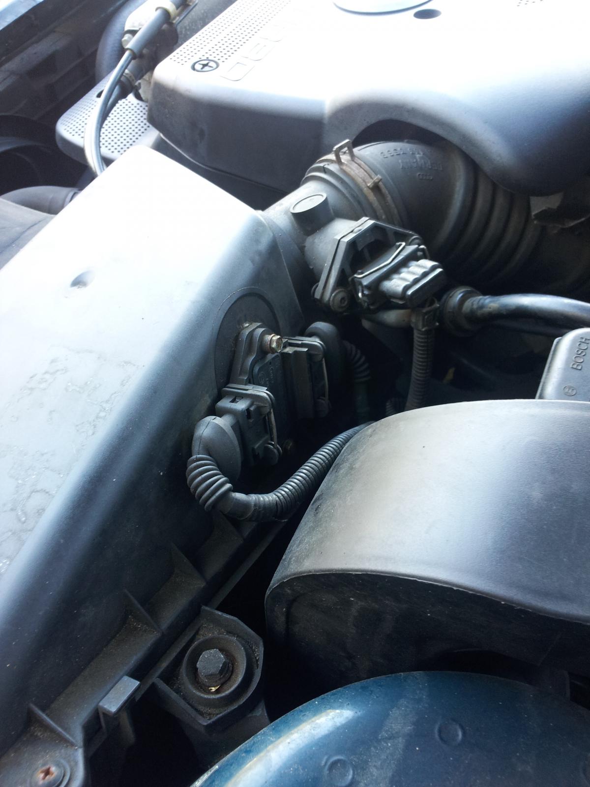

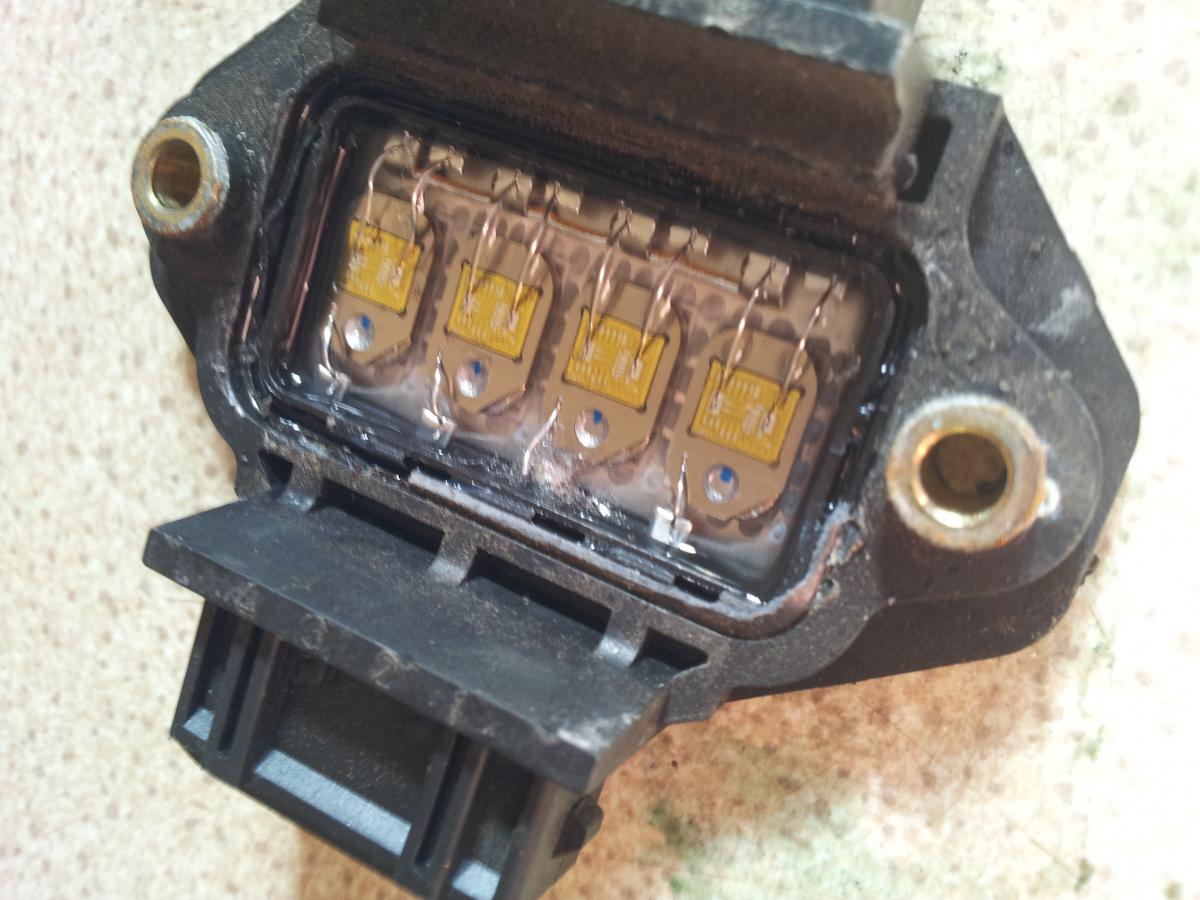

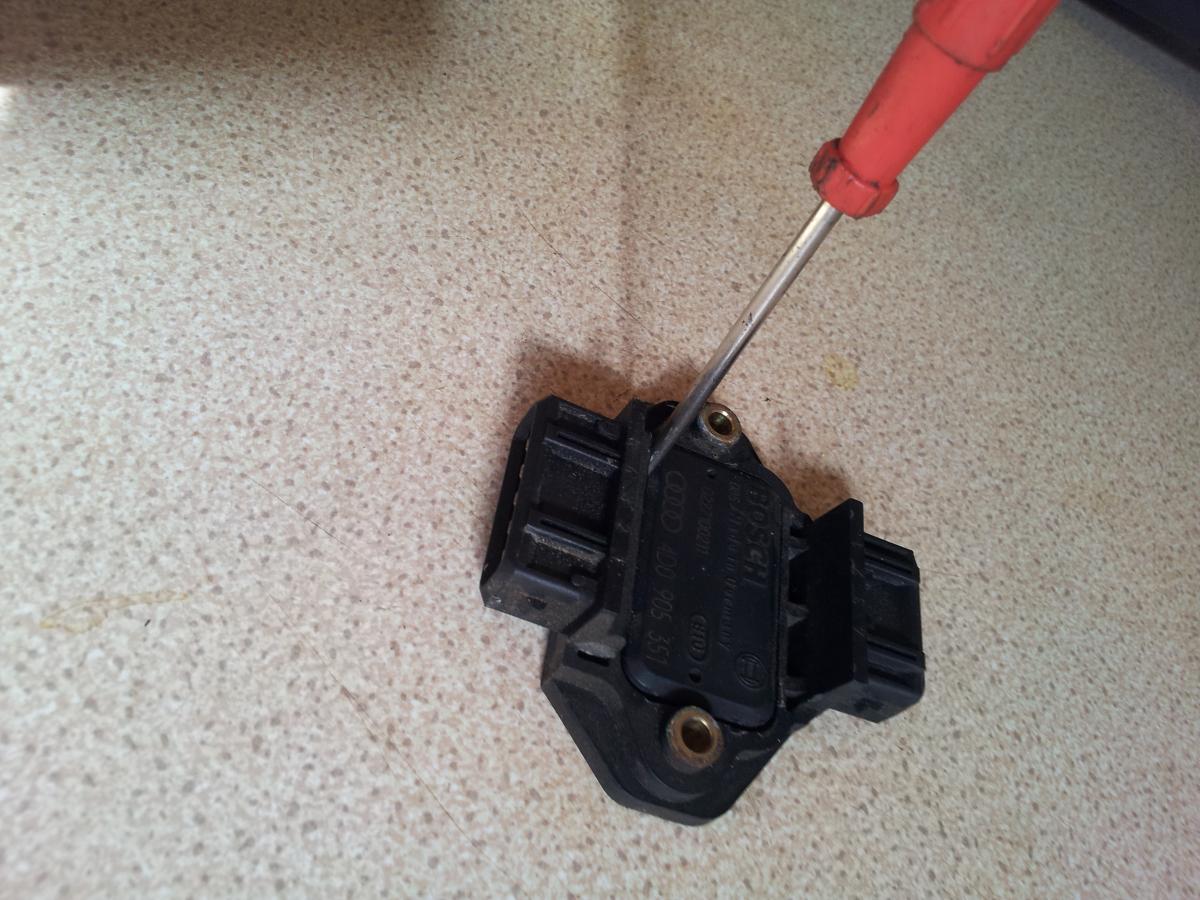

post-16569-0-12899000-1394395065_thumb.jpgpost-16569-0-80245000-1394395269_thumb.jpgpost-16569-0-52792200-1394395388_thumb.jpgpost-16569-0-35374500-1394395467_thumb.jpgpost-16569-0-23407200-1394395887_thumb.jpgpost-16569-0-56535200-1394395918_thumb.jpg
1 this is where the unit lives on the back of the airbox
2 close up
3 I disconnected the ICM, MAF and the air hose clip - 2 screws on airbox and the lid comes off
4 this the heatsink for the Ignition Control Module viewed from inside airbox lid
5 I used a small terminal screwdriver but a knife would probably be better, use caution here as inside is very fragile as you will see
6 inside the unit - hopefully you can see the broken wire on the second chip - you need to identify which wire is the problem and try and solder it back on to the pin - good luck with that - I couldn't do it but others have.
