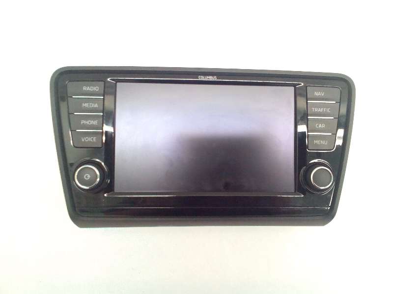

I just want to upgrade my Bolero! I manage to find somewhere on web only the display and I want to replace the original Bolero display with this one on 8inch. It's working or not?
or...
Anyone try to pair a mirror-link for iPhone to Bolero?
You're talking Bolero to Columbus; thats considerably more involved than a screen swap.
The brains for the infotainment are installed in the Glovebox; its the same profile as a single DIN headunit with the CD slot and SD readers.
You'd need to replace this also; would come in at approx £700 (€800) to purchase, then you've got to retrofit, code and get around the component protection (put in place to deter thefts and make retrofits difficult) not sure if anyone has managed this yet.
Id doubt very much just replacing the Bolero 5.8" screen with the Columbus's 8" screen would work.
