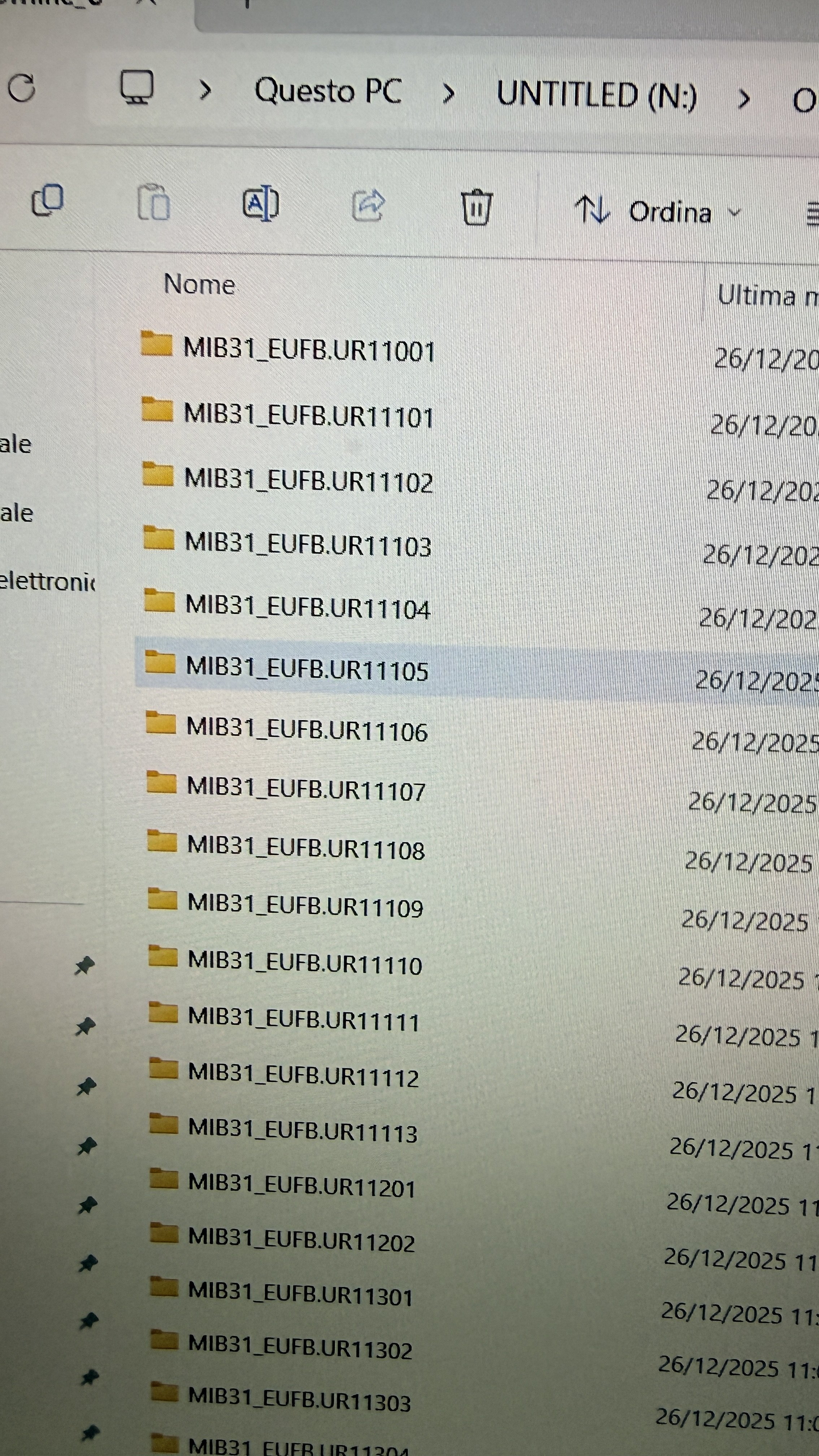

Hi and merry X-mas everybody!
What I don't get if I have to copy the main folder with all the subfolder inside OR all the subfolder in the main root; last but not least: if I enter in the Engineering menu (pressing and holding MENU button) system asks me to update the maps but nothing changes, except I saw the firmware version to be updated only when car is parked (but it didnt' change anything after a 2h trip) otherwise, while moving nothing chjanges

I unzipped the file using Windows explorer, so it looks like is NOT the right program to build the right “tree-line” in the root; even if I use a reversible USB C/A pen drive formatted as ex-fat.
I’ll try to build the right tree-line based on the linked post.
Attached is how I see actual tree-line
So I need to make folders named
MIB31_EUFB11
— MIB31_EUFB11001
— MIB31_EUFB11002
— MIB31_EUFB11901
MIB31_EUFB12
— MIB31_EUFB12001
— MIB31_EUFB12002
— MIB31_EUFB12901
etc. right?
Edited by Benja77
You do also get other issues if its not that. Some zipped files un pack at the wrong level so that pdf shows how it should be. Failing that you do get other issues which @MartiniB be has mentioned in the past. Basically the unit gets stuffed so you update the map with a previous history one then it takes the update. Weird. I dont have mib3.
Using Winzip is then useless at this point, better using 7zip, correct?
7zip is the Vag recommended way of doing it.
Ok thanks!
EDIT: 7zip extracts the folder as Winzip, why?
Edited by Benja77
Why 7zip is preferred as that during the unzipping process other programs can slip in that off character that destroys the integrity check. It has to unpack exactly the same way as it was zipped.

I opened the db as You showed in the link but I cannot reconstruct the correct tree-line
You drag and drop all of the contents into a blank USB at the route level then you are done. Otherwise it's one of the niggly issues as referenced above. I'm hoping @MartiniB will jump in if Ive missed anything,
That’s what i did but maps didn’t update 😅
