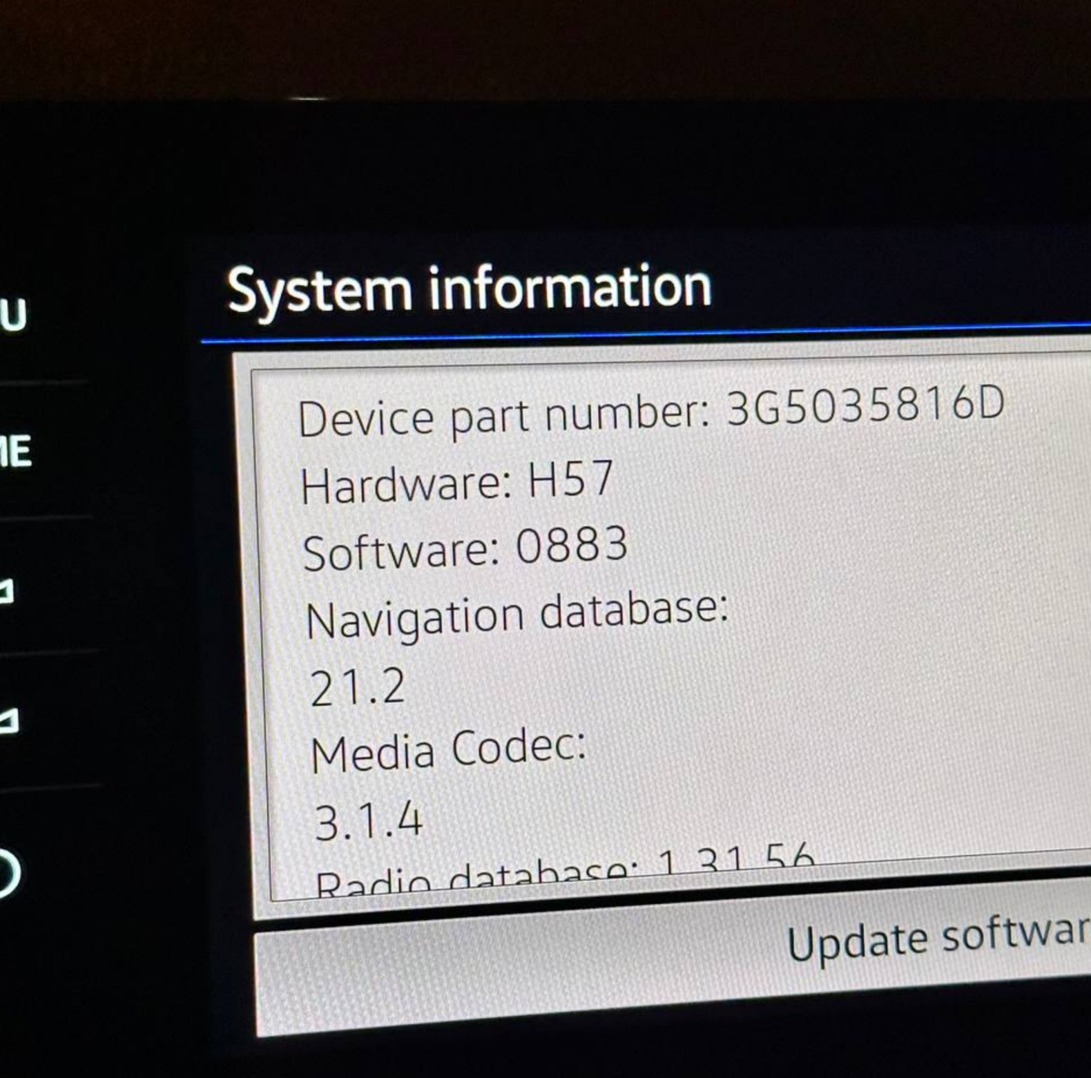

Hi,
So I tried to update the maps, I bought a USB C thumb drive, downloaded the file from here OI_P146_MRM_ISR_202525_Offline_Update.zip
Then i formatted the drive and unzipped, connected to the car and turn the car on, nothing happened I plugged it in both USB C ports.
I then went to Skoda update site, accordin to VIN there I see I need this file EI_S153_EU_202525_Offline_Update.zip which is 14Gb, the file from here is just 250M.
1. Why didn't it start the update? Do I need to o into maintenance mode?
2. Why the VIN number suggest a difference file then my country one from here?
Thanks

Hi,
So first I just bought the car around 3 months ago. Here there is only an official importer so the infotainment should be original from factory.
I'm not sure where it was imported from, but I do know it was manufactured in Czech republic, as it is stated in the car license.
The car have the hoghest spec sold here, and I have all the following features. virtual cockpit, lane assist, side assit, front assist, reverse camera, cruise control, traffic sign recognition, travel assist, emergency breaking I think it only break on reverse
So this is why I'm suprised. The car does NOT have built in GPS it relay on the android auto.
I wanted to have the maos updated since I think where there is no sign on the road, and android auto connected it take the speed limit from the map.
I also checked and it seems my VIN in the infotainment is not matching the car VIN, might be a security thing?
Available codes on the car
00050000 - bluetooh as far as I know, Installed
00070900 - can't find it, not Installed
00070d00 - could be apple car play, Installed
00070e00 - might be android auto, Installed
00072e00 - can't find it, not Installed
1 more code Installed but not in the available list dunno how that is possible
00070700
So I think I will try to use the maps the skoda site say match my VIN worst case it doesn't work
I think you are into the curse of the Middle East, African and Turkey set up cars. The question is whether it has a regular infotainment system then a retrofitter can enable what hasn't been enabled. No GPS aerial may be stuck. Certainly the Turkey ones can be turned on via ODIS coding via an authorised dealer.
If the Skoda site is pointing to European maps that would suggest its authorised for Europe. If you did manage to zoom out with those loaded and saw Europe then you would still need the RoW navigation FeC. Probably better experts on mib3 FeCs on the board here but unless they got an ODIS license they wont be able to do anything.
Vag put pay to the hobbyist hacking of these units with mib3. No tool kits except authorised equipment and software. The availability of the mib3 Israel map probably means it's sold on something or they are planning too. Previously no cars were sold with Middle East maps by the Vag group, you had to enable that. More challenging now.
As mentioned East Yorkshire Retrofits that has a presence on this board have offered to remotely enable aspects of mib3 for a cost if the buyer, buys that Vag adapter. They would look up your Vin and see what's actually in the car. That's my best advice. They are licensed to do this work.

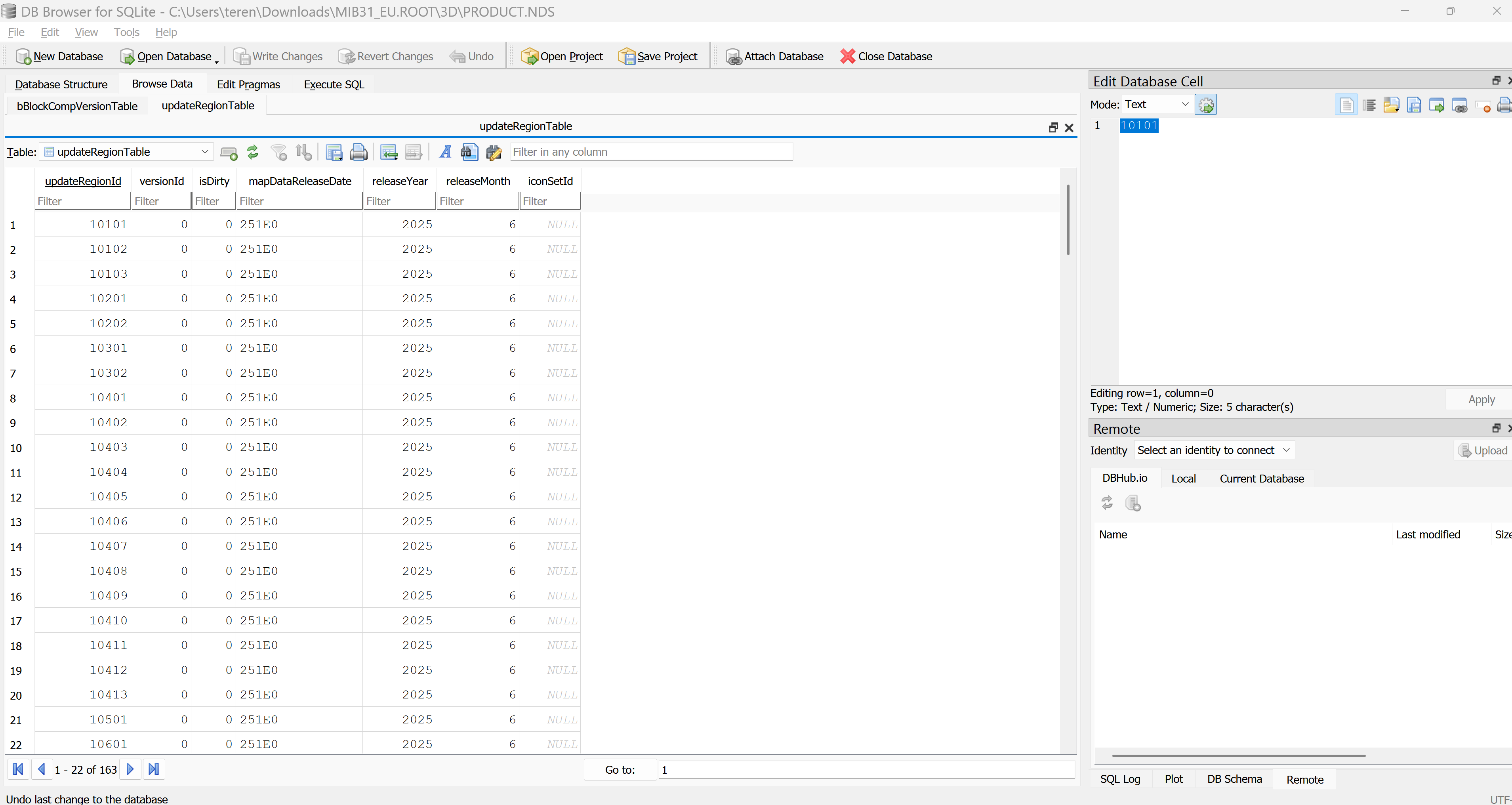

Update OI_P119_EU_202425_Offline_Update.zip contains data from 23.12 (YY.MM)... in this instance 25.06. That was a cut and paste job. Thank C34 again.
You can check this for example in the MIB31_EU.ROOT/3D/PRODUCT.NDS file. This is a SQLite database, you can find this information in the updateRegionTable table.
Probably only @MartiniB and myself plus a few others would check. It resolves what the file period is.

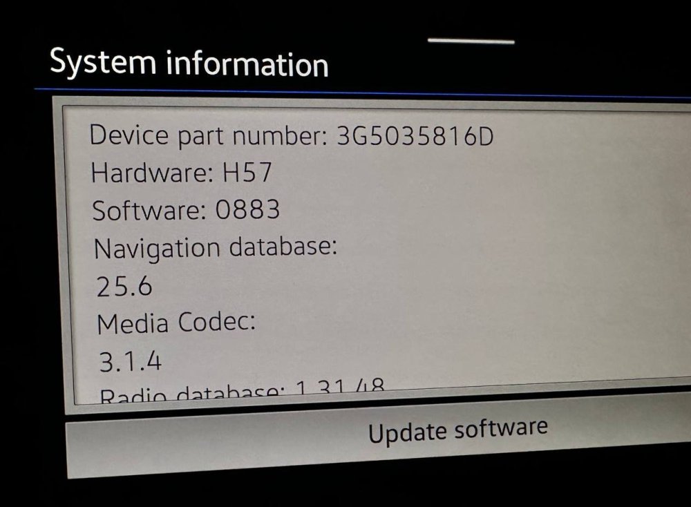

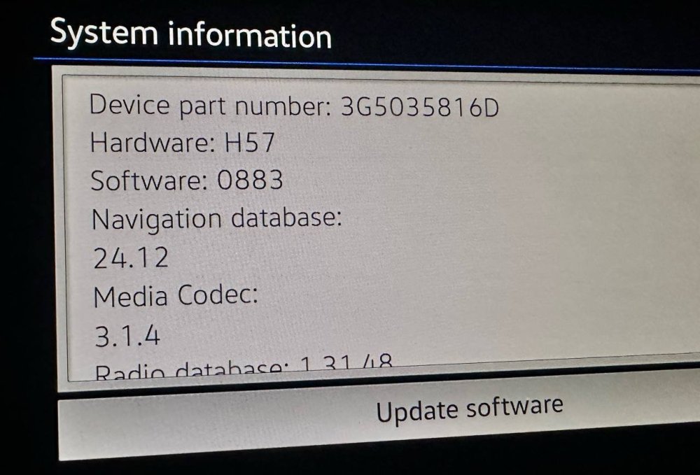

Probably some fixes. i have 25.6 already installed. I’ve been trying for two days to update to these, but nothing happens (no new version).
Probably wont since it already has you on 25.6. It will be a simple comparison of whether you are on that release already. The 154 code wont come into it. On a mib2 high swdl menu you can overwrite but I'm pretty sure you can't get swdl in mib3. All locked down. They dont want you messing internally in the unit.
