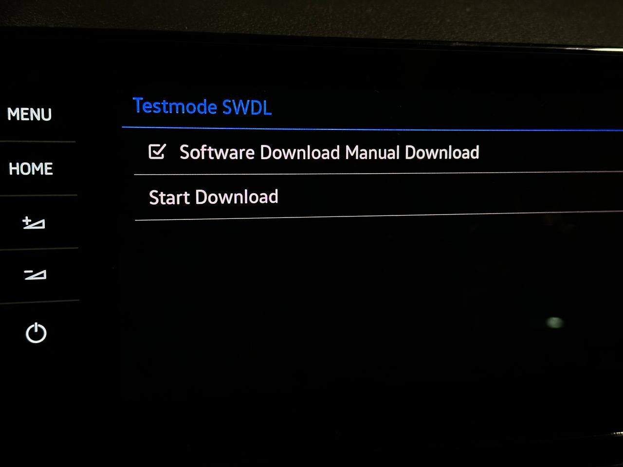

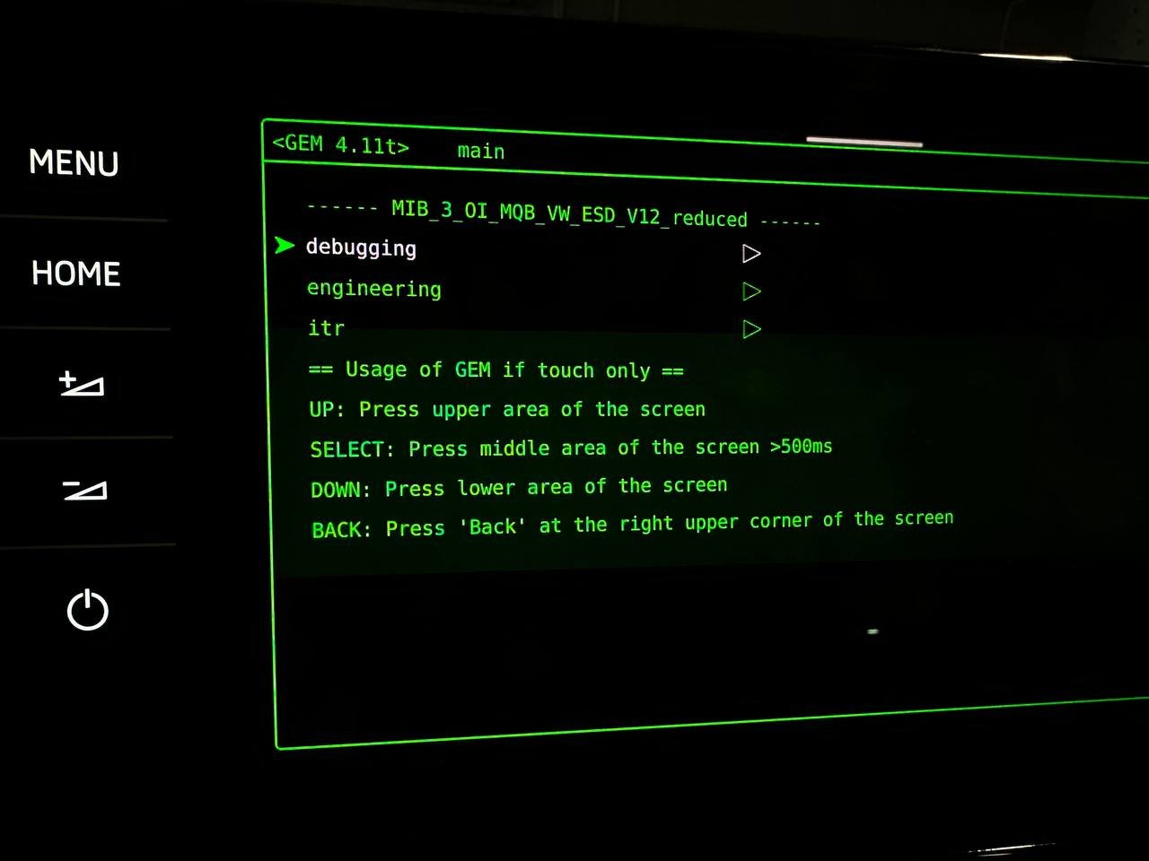

I have access to GEM, but it seems to be a reduced version. There’s some kind of SWDL here as well, it even has a checkbox for manual download, but nothing changes.
That looks like SWDL 👍 If its like mib2 high one you can write backwards as well as forwards and over write. You could try a previous map file.
Well if the USB is correctly formatted and the files unzipped and placed in the correct position on a blank USB... if like mib2 high you'd hit Start. It would examine the contents, do the signature check. A 5 or 10 second delay, then progress to another menu. If its not doing that may be presentation issues or the menu not working.

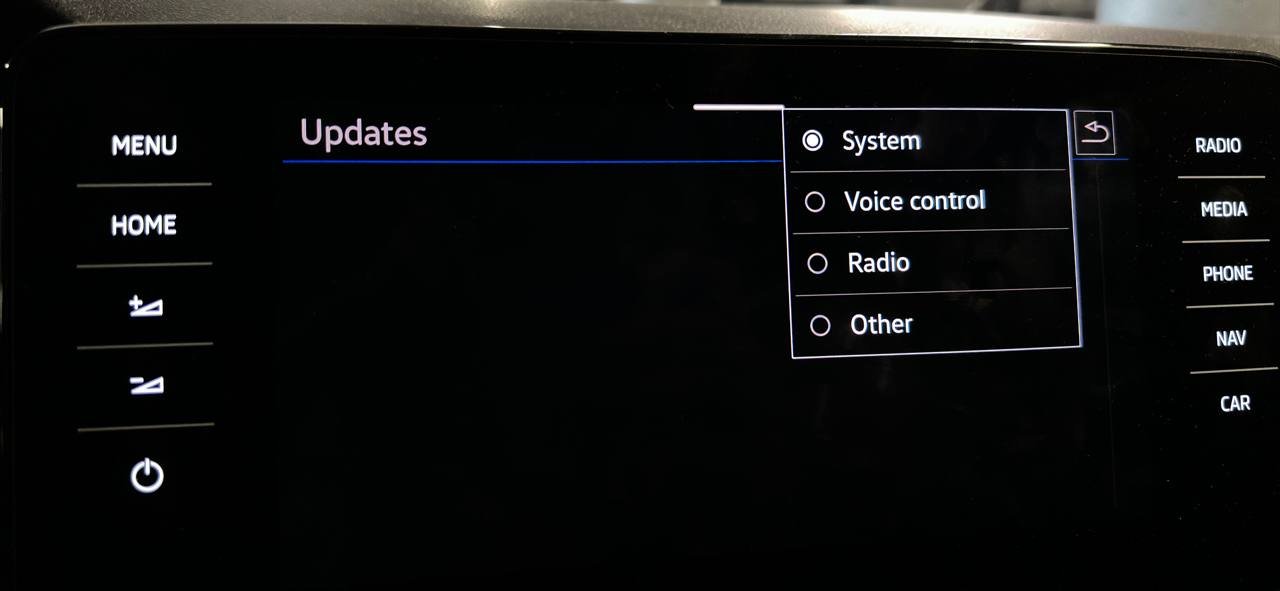

When pressing the button, the updates menu opens, but since the maps are installed in the background and don’t appear in any of these menus, there’s nothing here. I’ll try reinstalling the latest software using this menu, maybe that will help.

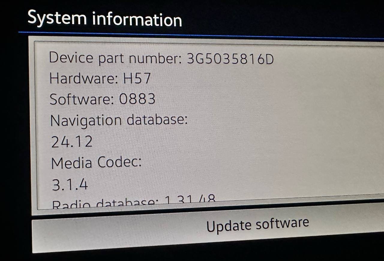

I tried using SWDL, but it turned out to be useless and didn’t work. I still ran the update with the same software that’s currently installed. From the whole update, only the postscript part was executed, and as I understand it, that was the key step. After that, I found out that Seat and Cupra had also updated the maps on their website and released version P141 24.12. I copied it to a USB stick, formatted in NTFS with a GPT partition scheme, and tried updating - and it worked. Then I uploaded the latest version, P154 25.6, and it was successfully installed as well. Hopefully this will be useful for someone.
P.s. after "reapplying" the software update, the radio database version changed from 1.31.56 to 1.31.48, so I think that’s what helped the maps install, by resetting something in the MIB versions.
Edited by wolfr4ge
Probably cleared out something in memory when you did 24.12 then moved forward from that. Still it's working now. Pity swdl doesnt work☹️.
