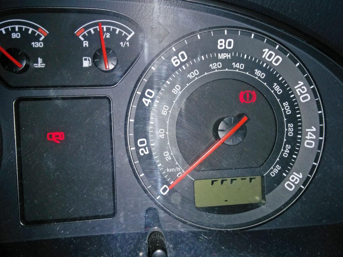

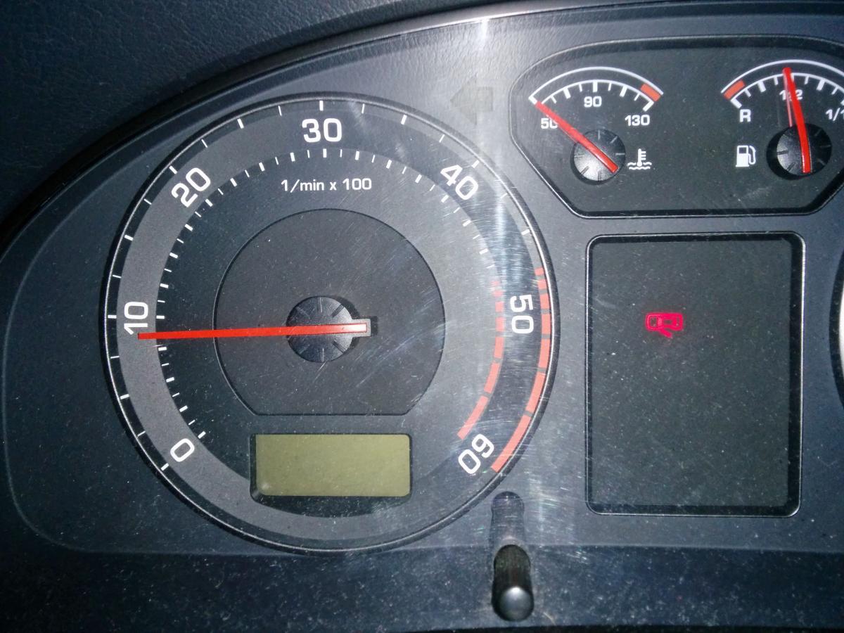

2002 Superb I Display Not working
As per the title both displays have stopped working - the one on the left is completely blank and the one on the right has some characters on it as per the photos...
Anyone got any ideas?
Water ingress problem id say under passenger footwell carpet..see water ingress at top of page...on the 23 pin connector going into ccm the dash display is pin number 1 Brown/yellow, and on the 15 pin connector plug, dash display is pin number 5 Brown/red...
