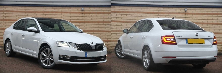

I'm picking up my new baby on Saturday... 2019 Octavia SE L in Moon White (4 months old, ex-demonstrator loaded with extras). I definitely like the idea of de-badging the hatch and this paint thing is all that concerns me. Given the youngness (is that even a word?) and whiteness of the car, will this paint colour change be a factor? I'm guessing not, just looking for reassurance. Ta in advance.
