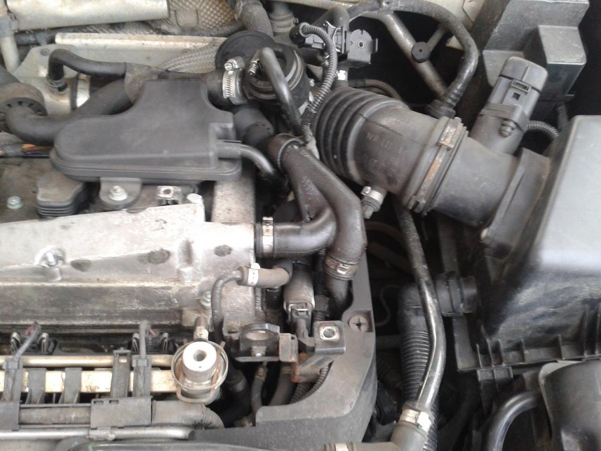

Would this split hose cause my idle woes and engine management light to be on?
The split is worse than picture. Also what is this hose called so I can get it replaced!!
