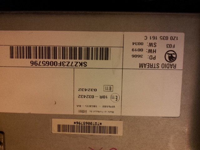

I assume if I go to one of those companies, I will need the long number?
What are the other numbers on this sticker, out of interest...?
SK number is needed to get the code;
Number starting 1K0 is the part number;
SW is the software version;
HW is the hardware version;
PD I don't know.
