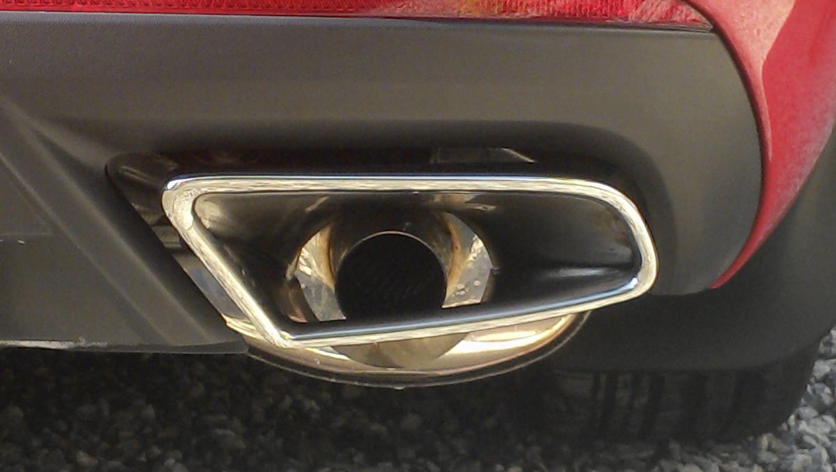

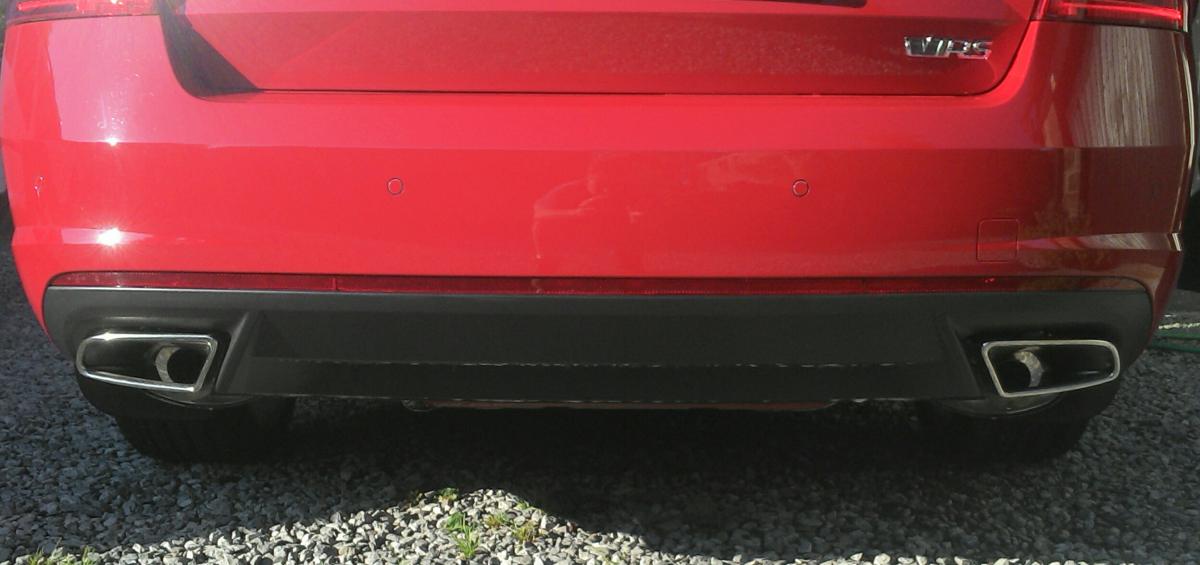

So, the car is back with a Cat back exhaust fitted. Firstly I have to say the guys at Scorpion were a pleasure to deal with, very professional.
I guess the main reason for me wanting to fit this was to make the car sound better and I have to say it it does meet that requirement. If your happy with the noise that the sound generator makes in sport mode,(without the rattle!), then this is what the exhaust sounds like from the outside, or at least that's the best way to describe it! A deep burble on tickover and not raspy on acceleration, although it can be made noiser with a non-resonated rear pipe.
I have tried to record the sound but its too poor quality to bother posting!
Attached are photos of the rear boxes and the dyno charts. Scorpion are waiting for the dyno people to send them a YouTube link of the dyno run, so this might give an indication of the sound.
Scorpion are just working out the costings for the system at the moment. If you need more info then the contact at Scorpion is Martin Lomas, Tel 01773744123.

From the website it looks like it. Although Martin did turn up out of hours when I dropped the car off in a Fabia vRS that I think had a different exhaust on.
im glad they've looked after you, our S3 saloon is supposed to be heading down there in a couple of weeks :)
Thanks very much for originally posting the request, it has been good to work with Scorpion, I'm sure the S3 will sound great!
Glad you are pleased with it, and nice that they left the stock tailpipe exits. When you can get a clip that you are happy with, I'd love to hear it. Looks like it frees up the top end a bit, which is useful. Did the system include a revised downpipe at all?
