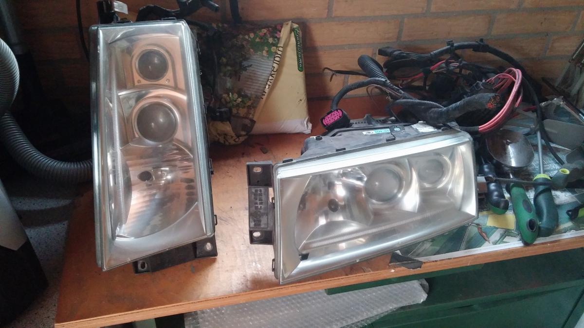

I bought two xenon headlights in Germany and I'm looking to fit these on my 2002 Octavia 1,9 tdi.
BUT... I have heard that you would need new wiring to make it work? Is that true? I've also heard that this adapter should do it:
http://www.kufatec.de/shop/de/skoda/octavia/octavia-1u/adapter-xenon-scheinwerfer-skoda-octavia-1u
Simply take out the existing headlights, and then fit the xenon headlight using the adapter and that will then using all the existing wiring.

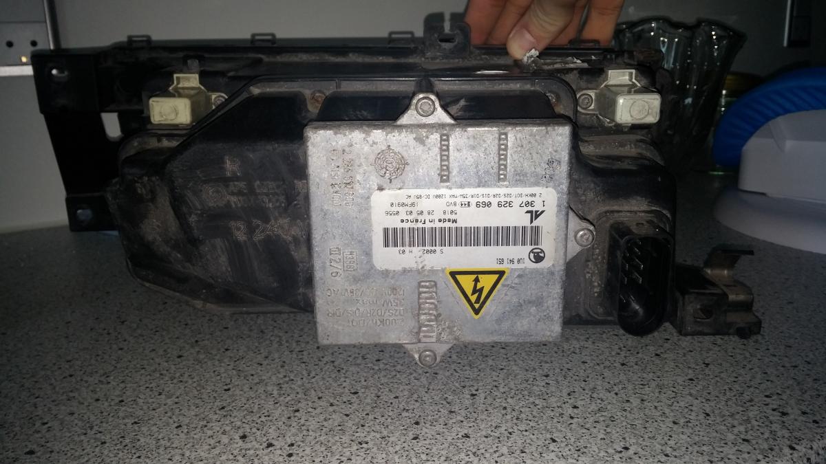

I've attached a couple of photos so you know what I'm talking about.

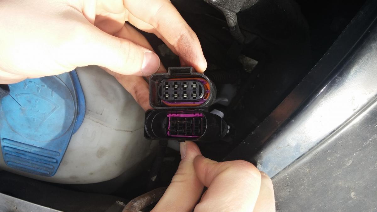

So I received the wires from Kufatec yesterday and all was good... Or so I thought... I tried fitting the wires today, but when I tried to insert the original wires into the adapter, they did not fit. :(
In the picture, the one in the top of the frame is the original socket that originally goes into the normal headlight - below that is the Xenon headlight adapter for Octavia 1U bought from kufatec - these two should fit directly into each other - am I right? .... But they don't ! :( Help is appreciated :)
Are the plugs for left and right headlights the same or different?
They are the same. :/
I'm fearing that this adapter simply won't fit for a 90 BHP 1,9 TDi. But I have no way of investigating this.. :/
Where does the other end plug in?
The other end of the kufatec adaptor plugs into the xenon headlights.
Can anyone be of assistance? Did kufatec simply send me the wrong looms? The plug in my halogens are 8 pin plugs, but the adapter I got from Kufatec is 10 pins on one end and 12 pins on the other?
