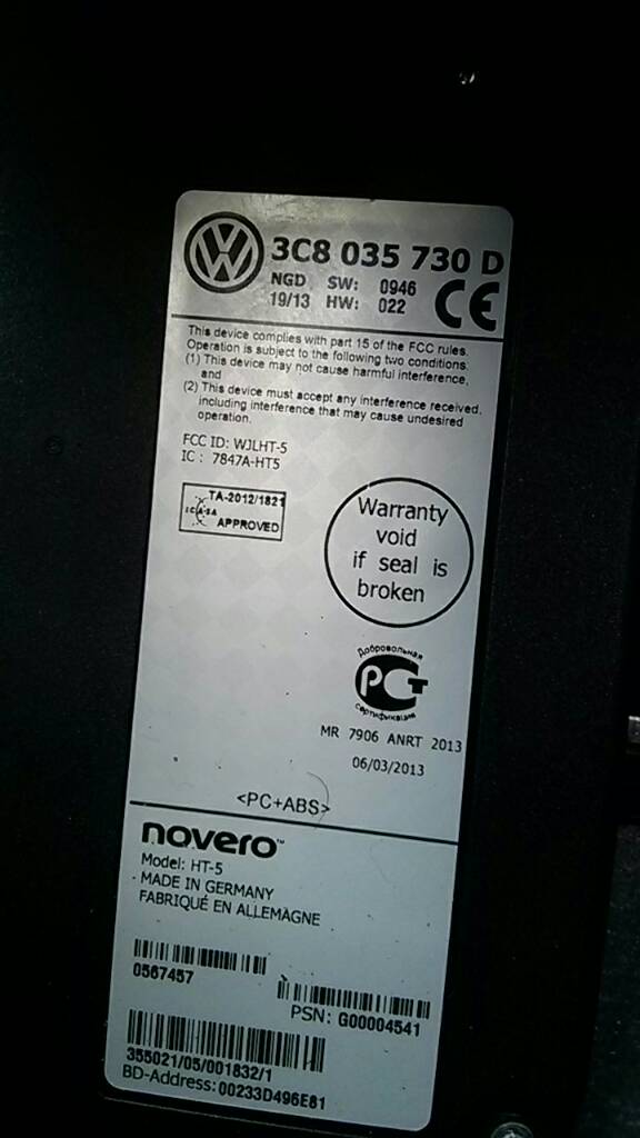

Just checked and it's def 3C8 035 730 with a VW logo made by Novero.

The 'D' revision of this module, as per your photo, supports rSAP and Wi-Fi.  My car came fitted with a 3C8035730B module (rSAP only) which I replaced with 3C8035730D, like yours, to add Wi-Fi.
