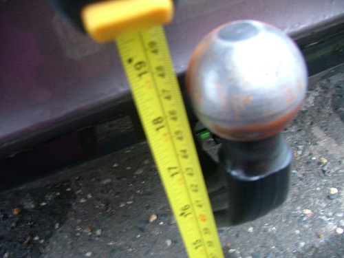

Have just booked a detachable towbar to be fitted (by MDS Towbars) to my 63 Superb 170 4x4 Estate L & K. The fitter has told me that both Witter and Towsure have stated that the height of the detachable tow ball would be 510mm on the 4x4. As the recommended height for our Bailey caravan (and many other caravan’s) towbar is a maximum of 420mm how can this work?
We have a detachable tow bar on our 62 plate 4x4 estate and have no problems with the tow ball height towing a Bailey Unicorn caravan. We have the Westfalia fitted, and the towbar height is around 500. It's a great solid outfit

When i next fit Westfalia towball shall take a pic of height measurement, but tows our big Adria no problem.
Apologies for pic quality but to centre of towball 46/47cm obviously unladen when hooked up this will drop a little.
