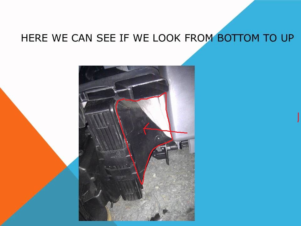

Hi basically i have bits missing and was hoping somebody could point me to where i could get replacements in the picture (attached if it works )
the highlighted red bit is missing basically i can just reach up and touch the filter.

also i have the clips but not the l shaped cover bit .

Probably only from Skoda itself, or try a breakers/scrapyard.
Often these random trim bits are not that expensive from dealers.
Try Skospares, they are a Skoda breakers yard.
http://www.skospares.com/
The L-shaped bottom cover for the cabin filter is part number 6Q0819422B
