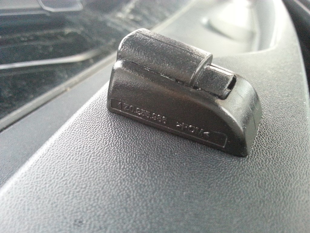

Hi,
I've ordered heated windscreen washers as a factory option. It seems that washers are proper as I checked their numbers (the same as for Octavia II) - photos attached.
I decided to check if they work properly, as we had 0,5 Celcius degree today in Poland, but washers were totally cold when i touched them. In my previous car (BMW) heaters were clearly warm when working.
Heater mirrors and rear screen were working properly in the same time.
Is anybody able to check if heated washers get warm in low temperatures? What ambient temperature allows heated washers to be activated? Is there any fuse to be checked (I don't see any info in Skoda manual)?
Good question. Do they come on automatically when it's very cold, or just when you have the heated screen on?
According to the manual they should be turned on automatically below 10 degrees of Celcius - I've just found it. So mine seem to be faulty :/. I will probably contact dealer tomorrow.
