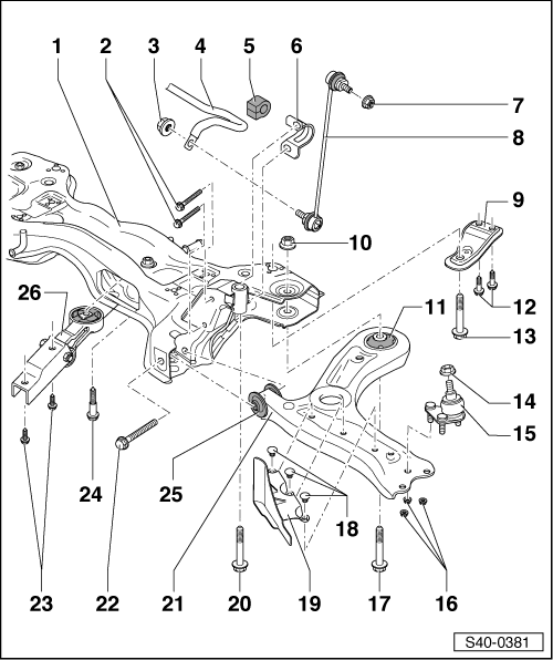

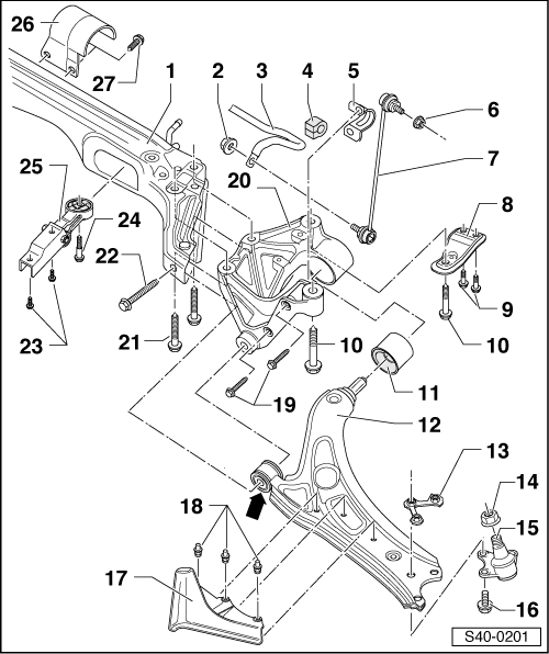

Yep, a little bit of research through ELSAWin during the weekend and it seems the change took place end of 2008 rather than 2011 as Superpro claim. Which means Superpro have been selling wrong kits from 2009 to 2011, really surprised how this hasn't got more popular.
Here are the two cases:
Up to 11.2008 and after 11.2008:
