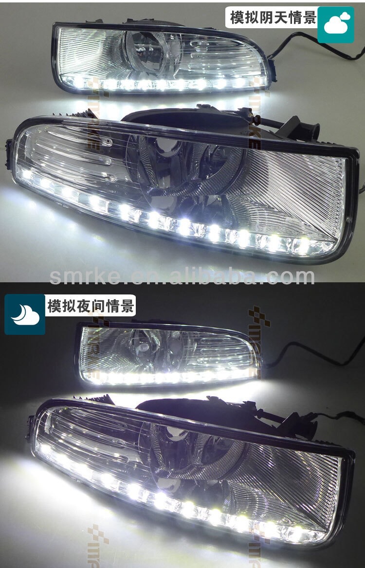

Ok, one step further - has anyone seen or got these fog lights with integrated DRLs?

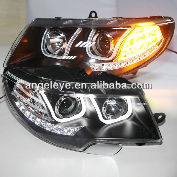

Or what about these headlights?
