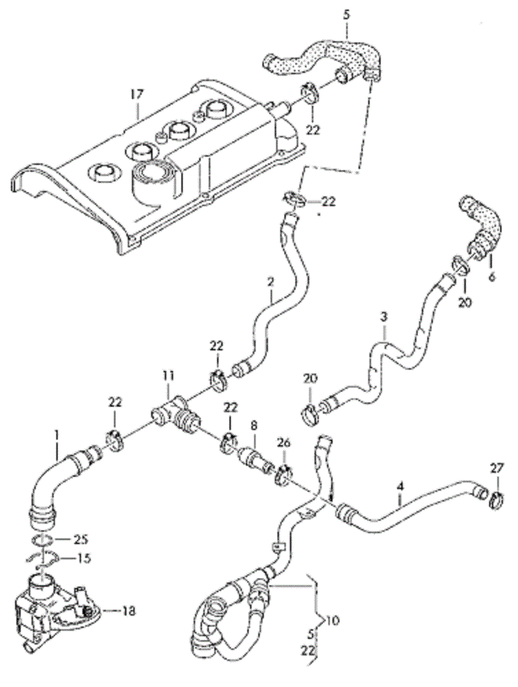

ok just got the car back and I have 2 split hoses, so can anyone point me in the direction of a diagram of the hoses along with the part numbers so he can point out the ones I need to order

have just changed the y breather due to it splitting, got the car in getting a new oil pick up pipe and service at moment and asked if they could have a look at the hoses and pipes to see if there are any issues. hoping it is something simple like a leak somewhere.....
 check the S pipe that goes down from the Y down under the breather because it can split also being under the manifold you wont notice.. was changing mine with a Creation motorsport silicone and my original was completly ragged and the smaller pipe that goes onto the bottom of the manifold had been chopped, a connecter added on and a different size pipe to the manifold from halfway.
Complete Bodge :wonder:
so I looking to replace number 2, 8 and 4... can anyone point me in right place for silicone pipes? had a look on ebay but not sure about what the part numbers are
yep, 2 was brittle and perished on mine.. and 4 was bodged..
I just replaced the S pipe from the Y pipe the other day, it cost 15.99 on Ebay.
here's the link for the S pipe (no.2)
http://www.ebay.co.uk/itm/Breather-Hose-Tube-Pipe-Rubber-SEAT-SKODA-1-8T-replace-ORIGINAL-PART-06A103213AF-/310845820727?pt=UK_CarsParts_Vehicles_CarParts_SM&hash=item485fdacf37
not too sure about the other two you need replacing, i never checked mine! Also you could do with a 1inch jubilee clip for the clamping it onto the T-pipe under the inlet manifold, as on mine, it was a crimped clip, which obviously once you take off, you need to replace!
