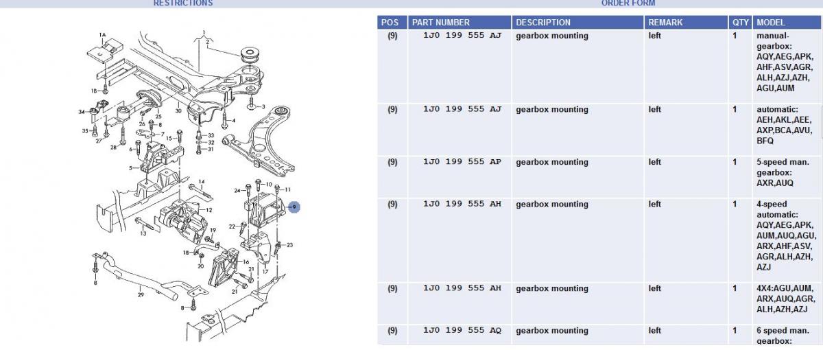

Hi Dude as mentioned
the mounts and bolts are in this drawing and i would replace them all i listed below
part number of bolts are
N10209603 x 4 (item 15 and 24 in pic)
N10516701 x 4 (these are the stretch bolts according to VAGCAT ) (item 6 and 10 in pic)
Yes, I'll replace them all even if it means delaying the work. I thought only the one type were stretch.
Annoying as the mounts will arrive tomorrow, but I'll only have half the bolts.
