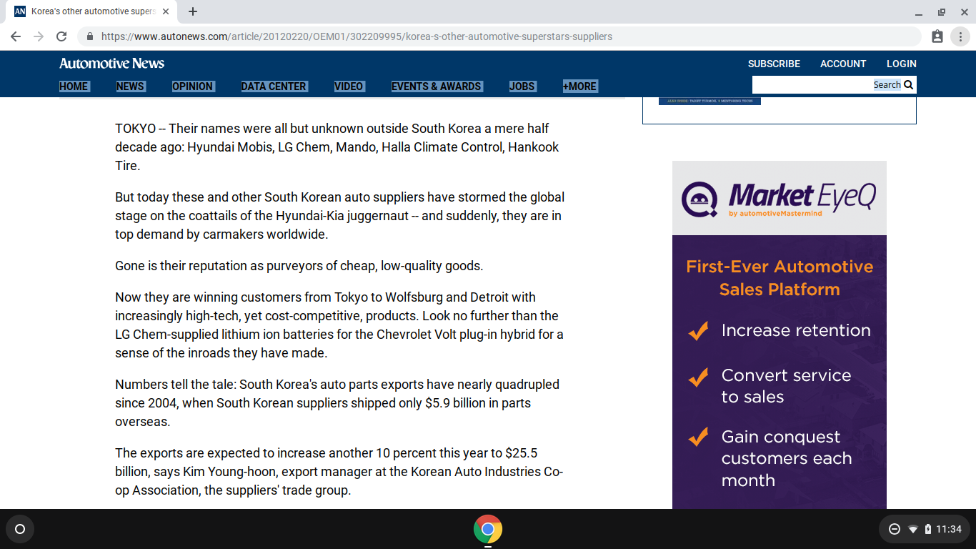

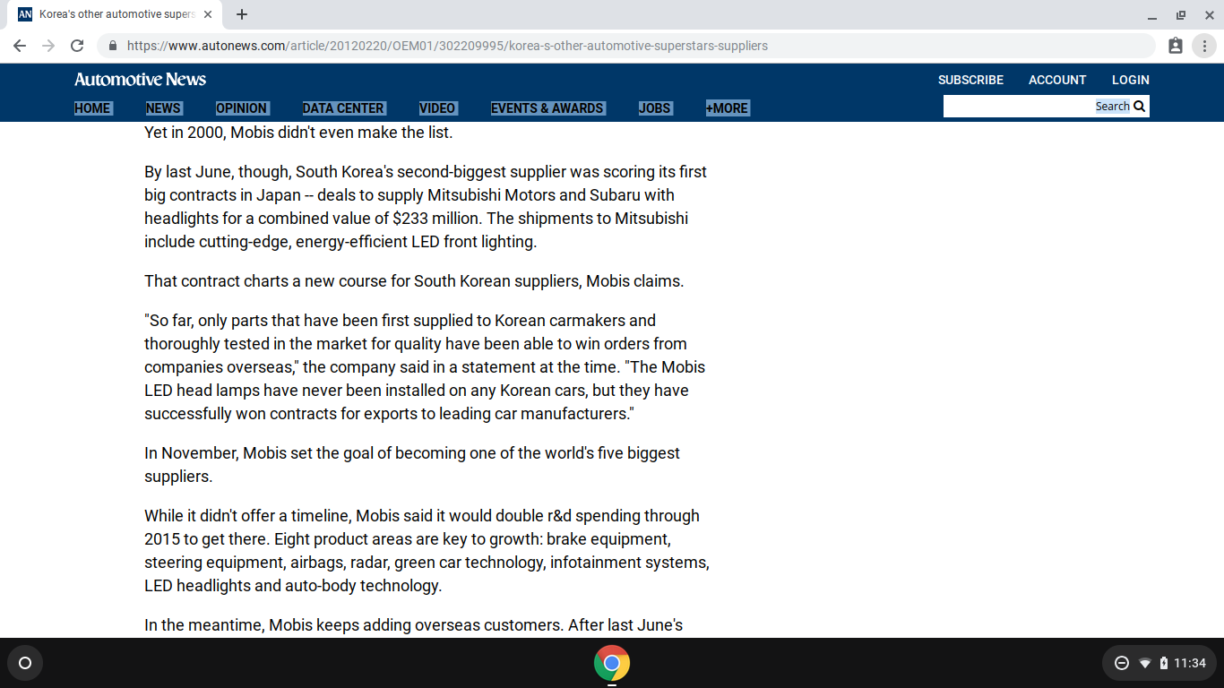

Chinese made discs are fine quite often, that is not an issue, they come at all price points.
Look around cars in Car Supermarkets and you see which are showing cosmetic corrosion and which are red with rust.
Look at old cars sitting in dealerships / traders that might not have moved for weeks or months and will drive off without issues and stop without needing to give the brakes an Italian Tune-up.
South Korean seem to be fine for many manufacturers with Global Manufacturing and sales.
