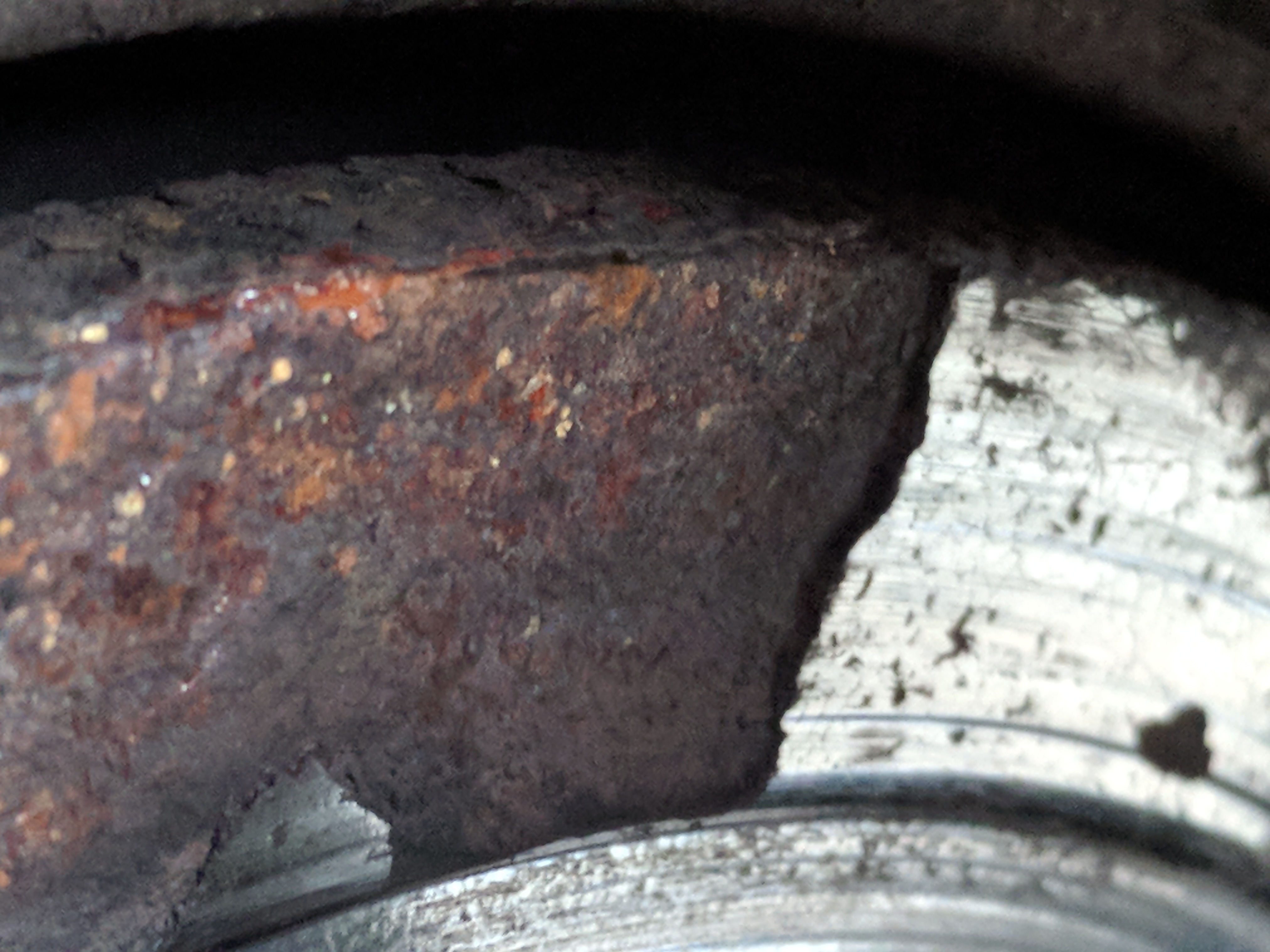

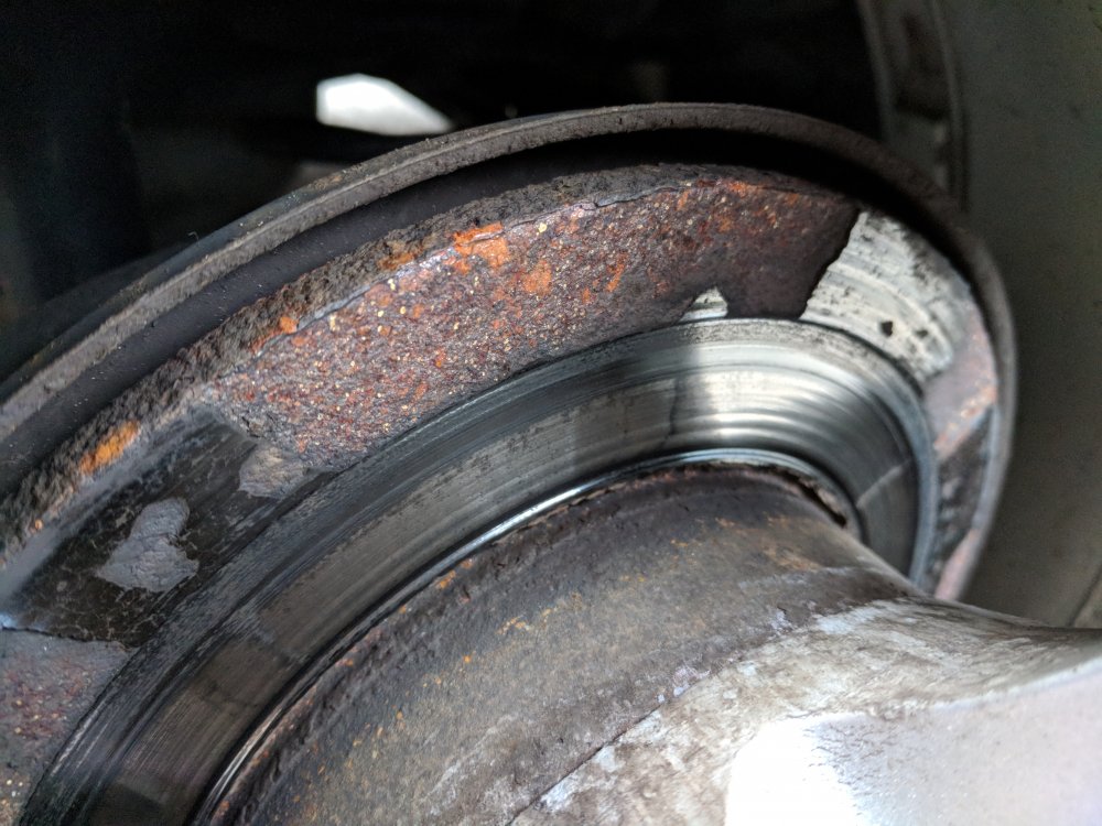

So I've never seen this one before. Looking for opinions! Greenline II, 2012, 65K miles and full service history. No discs replaced to date.
Rear brake discs (both sides) are corroded. MOT three weeks ago specified "rear brakes badly corroded".
When putting air in the tyres, I noticed the face of the discs has started to shear off!
I don't think it was this bad when I took it for the MOT, but heavy breaking and extreme weather over the last couple of weeks may have impacted.
Has anyone seen this before? I always assumed discs were one piece of iron, without a "face" per se.
The corroded areas are definitely ~1mm lower than the clear areas.

@Jason88 - The "face" of a brake disc is the area that the pad rubs against.
@Wino - Correct; it's quite common for brake discs to be case hardened (as the name implies it's a surface treatment).
I believe discs can be ground/resurfaced to some degree but the wear limit must not be reached. Having said that, they are not that pricey from many outlets and as they are such a safety issue, why risk it? Unless you have the correct equipment and know-how, it will probably cost more to get this done anyway!

@mrgf pop your glasses on and then have another look at the photos. That's not surface rust that could be scraped off, it's effing great slabs of disc surface dropped off!

That's one of the strangest things I've ever seen on discs - that looks for all the world that these have some sort of laminated surface, which is de-laminating.
These pictures are very impressive, I could spend an hour or so knocking all that rust off, it looks like it has been wearing nicely over the complete swept area, then at some point, probably after sitting in a used car area, it has grown that rust that is now not getting grabbed by the pads!
I'll guess the pads are not as free as they should be to move in the calliper carriers either, old bits old followed by a good clean up and then new discs and new pads needed.
Edit:- to the OP these discs are not shearing, you would know very quickly if they were, I returned from a holiday abroad to find that my wife's Fiesta had suddenly acquired serious vibration in the front brakes, when I went to replace them the one that was starting to shear off broke off completely leaving only the "top hat" section on the hub, I did not see that situation coming!

There wouldn't be any point. As the OP says the top millimetre of the disc surface has fallen off, exposing those rusty areas beneath.

I still can't see that it is the rusty stuff under the silver steel, I've never ever seen that and I've seen discs that have been used down to their limit and below, even when "blown up" in magnification, that rust still, to me looks like it is above the silver intact but worn down swept outer areas - either way, that is very unusual for a disc to end up looking like that - heavily corroded yes, but showing sliver steel sections in amongst the heavily rusted area, no, not seen that before.
I'd be very suspicious about discs having surface treatment, these discs normally get their "qualities" from the steel used, and as the wear limits are way deeper than any surface hardening would exist that is the way I've always understood things to be.

One of the garages I went to between OP and now - the mechanic was pulling/chipping off the silver surface with his fingernail to reveal the rust beneath like a scratch card! He also called it a "cheesegrater" for my brake pads.

I promise you, it was rust under the silver steel. As I say, like a scratch card where you win rust!

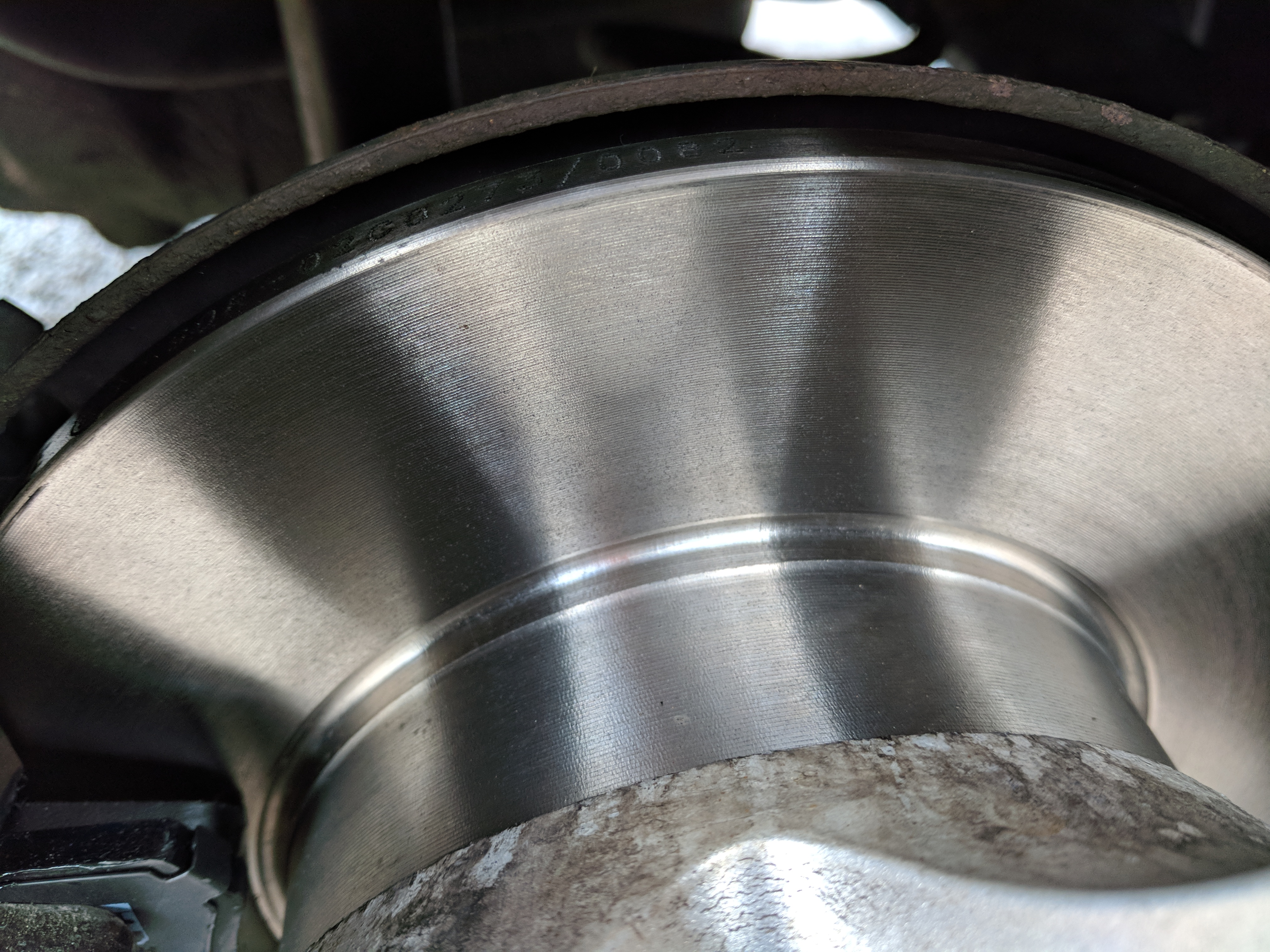

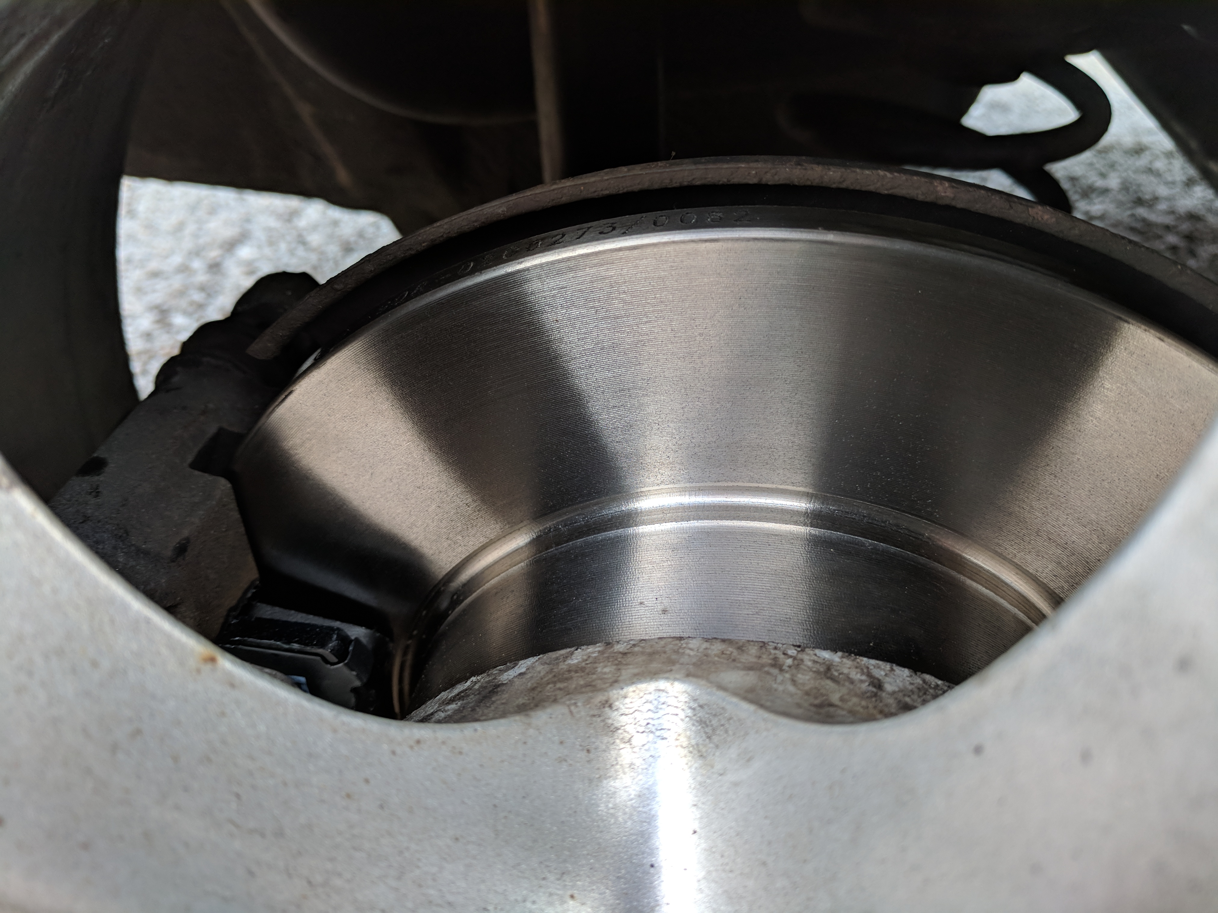

The good news is I did the sensible thing, and this is how they look now. Phew! Expensive but worth it.
Thanks for all the input!
Best, most sensible solution. Anything else would've been both dangerous and irresponsible. :thumbup:

I have seen many a brake discs like that, the discs are case hardened (heat treatment, so they can with stand the wear and heat cycles they go through.)
They start to pit first then they rust and corrode, it's this that breaks up the surface and cause rapid corrosion to the disc, once this happens the only option is to replace them (skimming won't work) The op did the best and safest thing.
