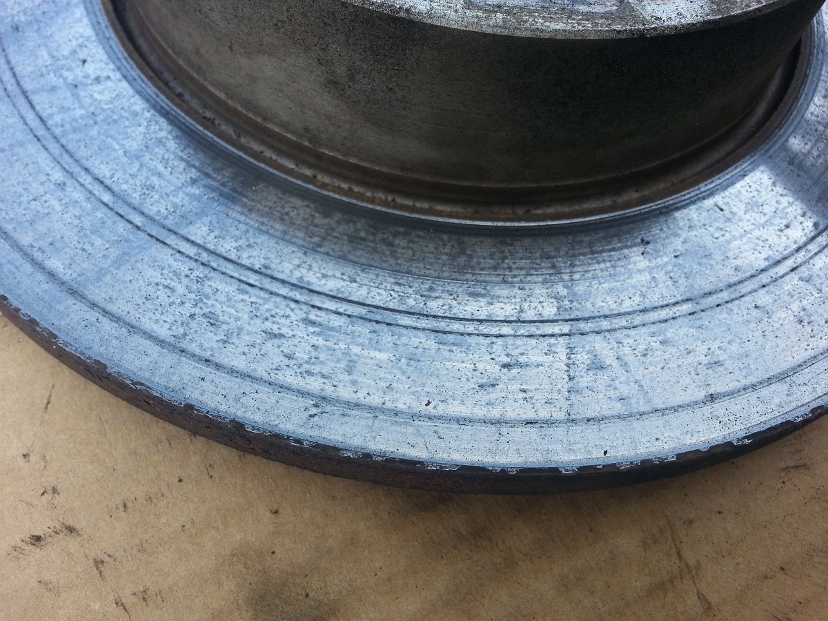

I had to order new brake discs
Emil,
were the pads worn out replaced then worn out again, before the discs are requiring replacing.
Or what is the story on the pads?
(where Discs wear quicker than Pads on a City Car, the Manufacturer is needing to look at their Part Choice & Suppliers,
especially the Global Manfacturing Group trying to be the worlds biggest.)
How was your winter and salting of roads,
and do your discs get surface corrosion overnight?
Can you get an actual measurement of the disc thickness as they are now ?
From a Google,
New they are 22.0 mm. thick Minimum thickness 19.0 mm

    Went in to the dealer today, short drive to demonstrate the issue. back to garage and the run-out was measured and new discs and pads fitted under warranty. All done in less than 2 hours. I'm impres
  • Have you been racing the car around the forests WRC style? Warped discs usually caused by over heating? Or maybe a manufacturing fault?
  • Do you have drums or discs on the rear? You problem could be your low mileage and not being hard on the brakes. Crud builds up on the discs which causes vibration like warped discs. However dome goo
Pads are from the factory line. Car is driven only 15 000 km at the moment. Pads and discs aren't worn much, if at all.
I'm hoping that dealer change pads and discs in couple of weeks. Let see who pays.
Yes we have salt on our roads at winter. I don't think that salt can cause warped discs. Surface rust yes, if it was raining, but nothing more. Brakes looks normal.
No rust does not cause warping. But have they been checked to see they are warped? You never said. Common warping but not common generally. Is cooked brakes, then Ford a stream. But then you know. Just like braked cooked and then sat with foot hard on pedal. But that used to be pre vented discs.
Replies #9 and #18
Edited by Emil
Yes I read that stuff. If I still have discs on a car I check them the way I true a push bike wheel, I set up the steel tip and turn the disc. Old fashion and very accurate. Good luck with it.
Looks like problem is solved. New discs and pads. I'm not sure who paid the costs but this time it wasn't me.
Good to hear that's it sorted at no cost to you.

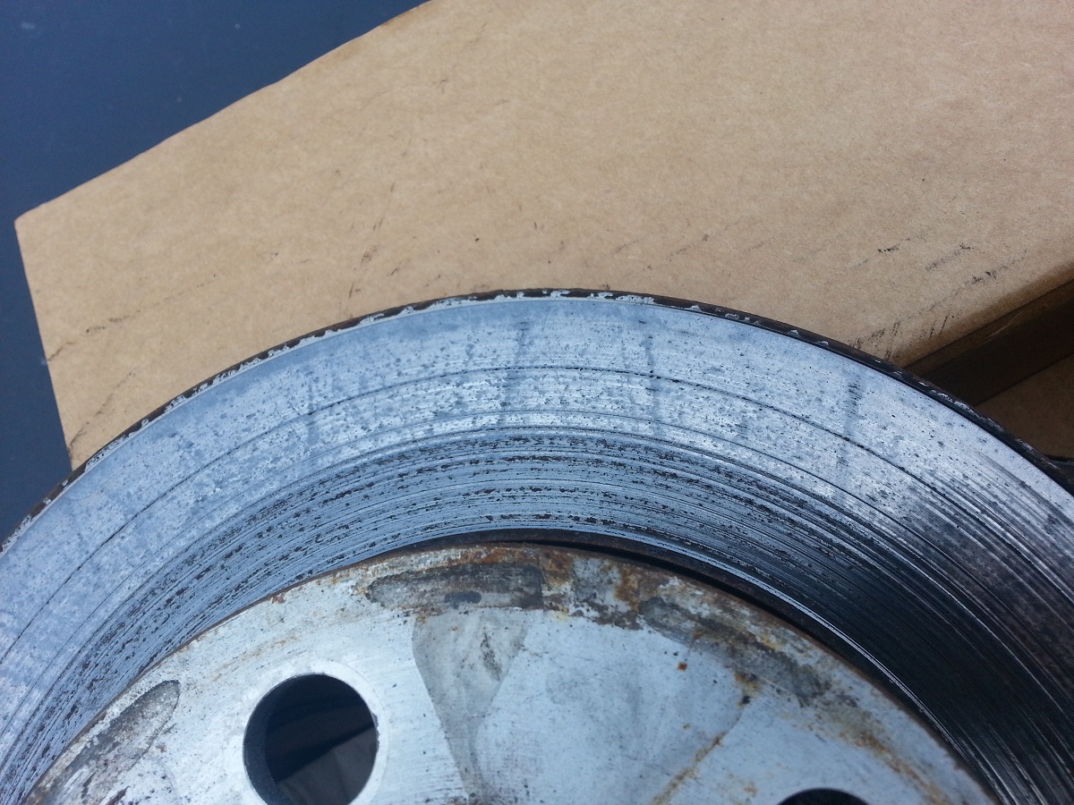

I think there are issues with the discs, no special driving techniques needed, but my first set where showing signs on warping at 3000 miles and got progressively worse until I swapped them for APEC ones at 28,000 miles.
I had to change brake discs and pads on my wife's car (Seat Mii)... There ware discs tear and wear... :thumbdown: I think it is quality issue...
Just under 16 000 miles
Has been changed for Bosch discs and Brembo pads...

I think all fault are pads quality. They are to hard and brake discs are gone...
