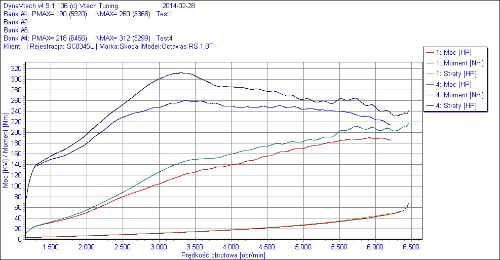

Remap 218hp

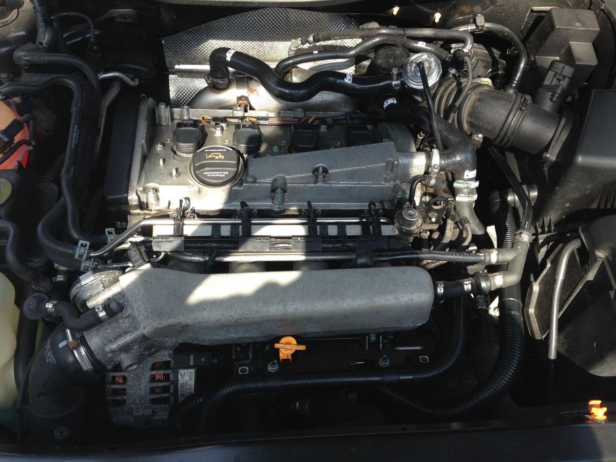

2. What would be my next steps in cleaning up and increasing the performance of the car? I have found this really nice intake manifold, do they really increase the performance? by how much?

The IE inlet will increase performance on a big turbo car and maybe a tad on a ko3s equipped car,but all the power increase will be in the top end at the expense of low down grunt!
Even on a big turbo car it loses power and torque below 3.5-4k rpm!
Why anybody would fit one to a ko3s car mystifies me!
My car is 370bhp and I wouldn't fit one of these for performance reasons because of the power losses low down! I would fit one purely for looks,but then,it's not even that good looking a manifold,is it?
If you were going to put £800-900 into your car you'd be better getting a decent set of KW coilovers,some meaty anti roll bars and a set of polybushes or maybe even a LCR front end setup!

What other supporting mods do you have for 218hp? Or is everything listed
Thanks guys! Where could I get those parts ? How much would they improve the performance ?
The 218 hp is actually before any mods, I got the car stock and used from Switzerland with no mods done to anything and the dyno guy was mistified that it had 190 hp :P
