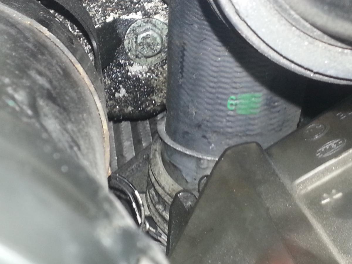

Cheers for the reply guys, think I found the culprit, boost pipe is off as it goes under the wheel arch, crap is sprayed everywhere and I can't get to it >:(
I have reason to believe you gotta take the wheel off and pull the plastic out the wheel arch to get at that pipe.
Good Luck!
Boost pipe off

Just pop the headlight out, only four screws and the plug and that pipe is much easier to refit.
check the clip isn't broken and that the ridges on the pipe haven't worn out.
Yeah did still have power, as in still very quickly got up to motorway speeds. The pipe that's come loose had evidently been spraying **** all over the surrounding areas of the engine bay but with the speeds of the air passing through I guess the majority went straight on down the pipe and only a small percentage escaped because of the pressure differences.
