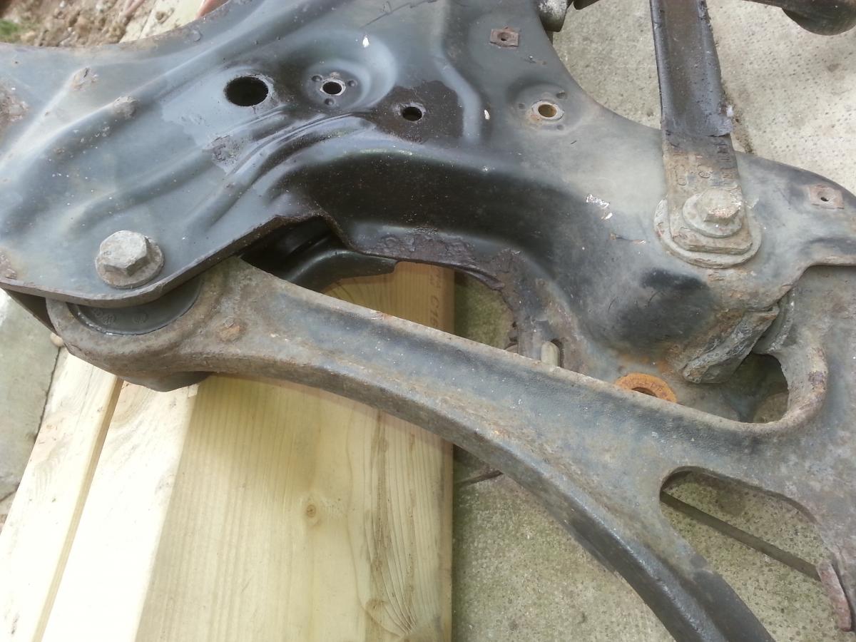

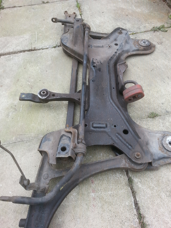

Problems... Basically I have noticed my suspension has been knocking a bit but only when I turn (coming from the left hand side) and I have heard the power steering pump whining a bit, so I can only guess something has gone pear shaped/going pear shaped with the rack/pump/bushes so forth. So I thought... TT bits? I found someone breaking a TT 225 and I have asked for the subframe, wishbones and rack (£170, good price?) just wondering if I should grab anything else whilst I am there? Also, pictures attached. Does it look alright? post-56735-0-86411900-1398268194_thumb.jpg
Grab the hubs too buddy as these make the complete change. Yes it does look ok and has cast wishbone's which TT , LCR and r32 has

Get rid of the bracket on the left side wishbone and the red bush/bracket as not needed for octy.
Also fit new TT wishbone bushes to the rear as they are better and two piece than the single vrs bush.

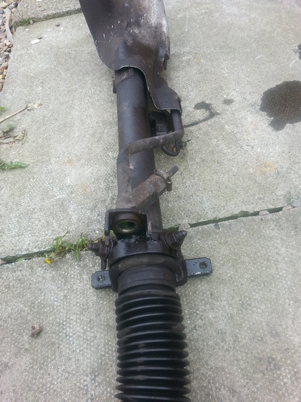

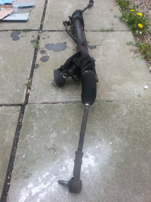

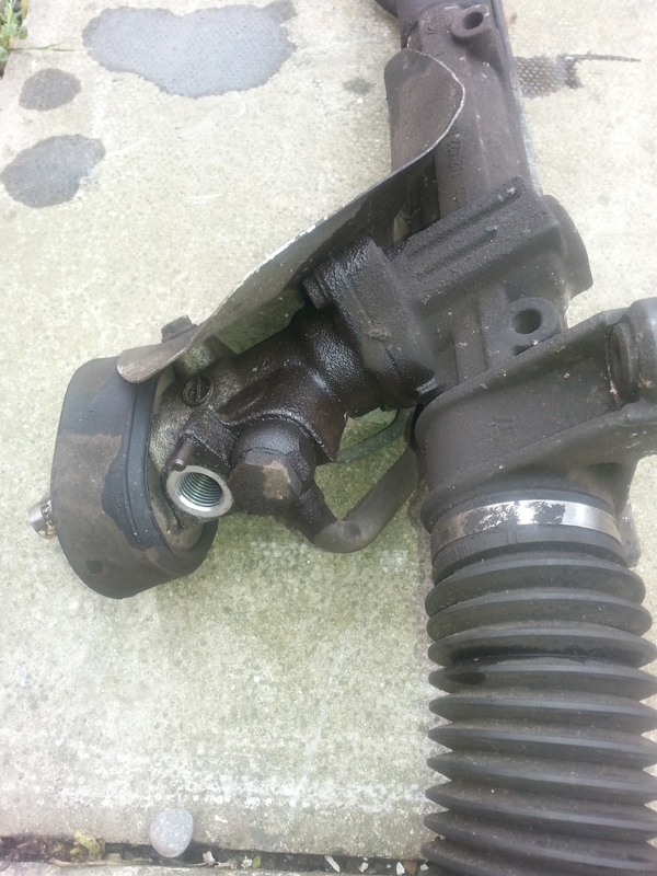

post-56735-0-34059200-1398511165_thumb.jpgpost-56735-0-13139800-1398511173_thumb.jpgpost-56735-0-15827000-1398511184_thumb.jpg
Does it look alright/missing parts?
Looks all there to me. You might want to replace the steering rack bush for a poly one whilst off. Also by new olives when installing the pipes..

I have the full part number  list  for the whole sub frame install if you need it buddy but for now here is what you asked for
Steering Parts
8N2422061H                  Steering Rack (quick Rack) 2.6 turns approx (LCR/TT/S3/R32) sometimes have 1J2 422 105 on them
N 100 155 06 (7)   X 4   Steering rack Bolts
N 013 849 4          X2    Steering rack pipe seal washer (olive)
N 013 848 7          X2    Steering Rack pipe seal washer (olive)
Steering rack bush / boot kit x 1
PFF85-416          x 1 Powerflex Steering Rack mount(optional but good choice)
or
PF3366K             x 1 SuperPro Steering Rack mount(optional but this was my choice)
here is power flex one
http://www.powerflex.co.uk/road-series/product-details/Steering+Rack+Mount+Bush/500.html
